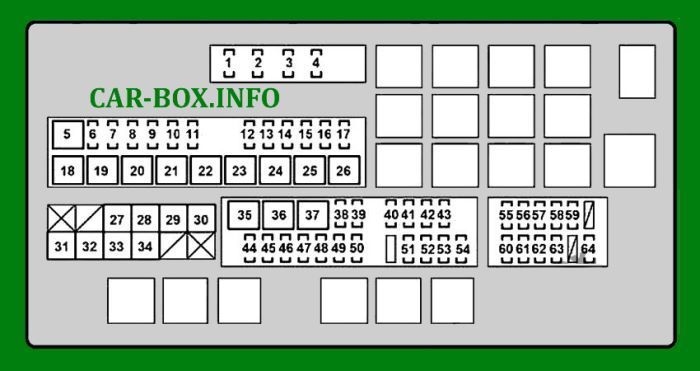

In the fuse box under the hood, labeled interior lighting. If that fuse is good, I’d use my multimeter to check continuity of all the other fuses. There are a lot of them but they have test ports for the multimeter probes so no need to pull any of them so it won’t take long. There are also fuse panels in the interior, one under driver dash and other under passenger dash. Interesting in that the two interior fuse boxes each is powered through a fuse in the main panel in the engine compartment, which I never realized before.

I had found that diagram as well and it's not correct. I believe that may he for 2015 and below.
Looking at the layout and the cryptic labels, it's not clear to me, that's why I was hoping there was a more verbose diagram.
