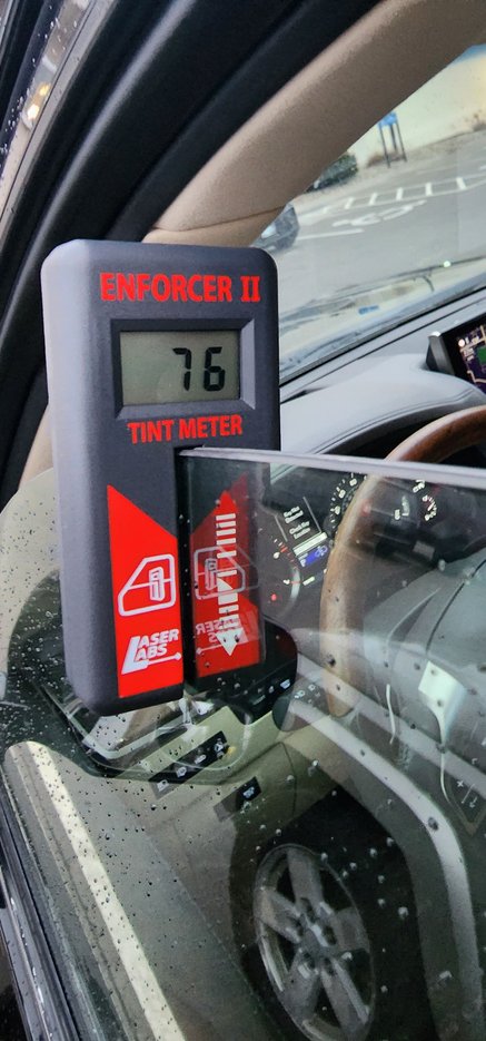

Here are stock numbers on a 2016 LX. Just remember that any tint applied will be compounded by what's already in the dyed window. This is usually only a matter of legality and you can tell for personal preference by holding sheet up to the window for your taste.
