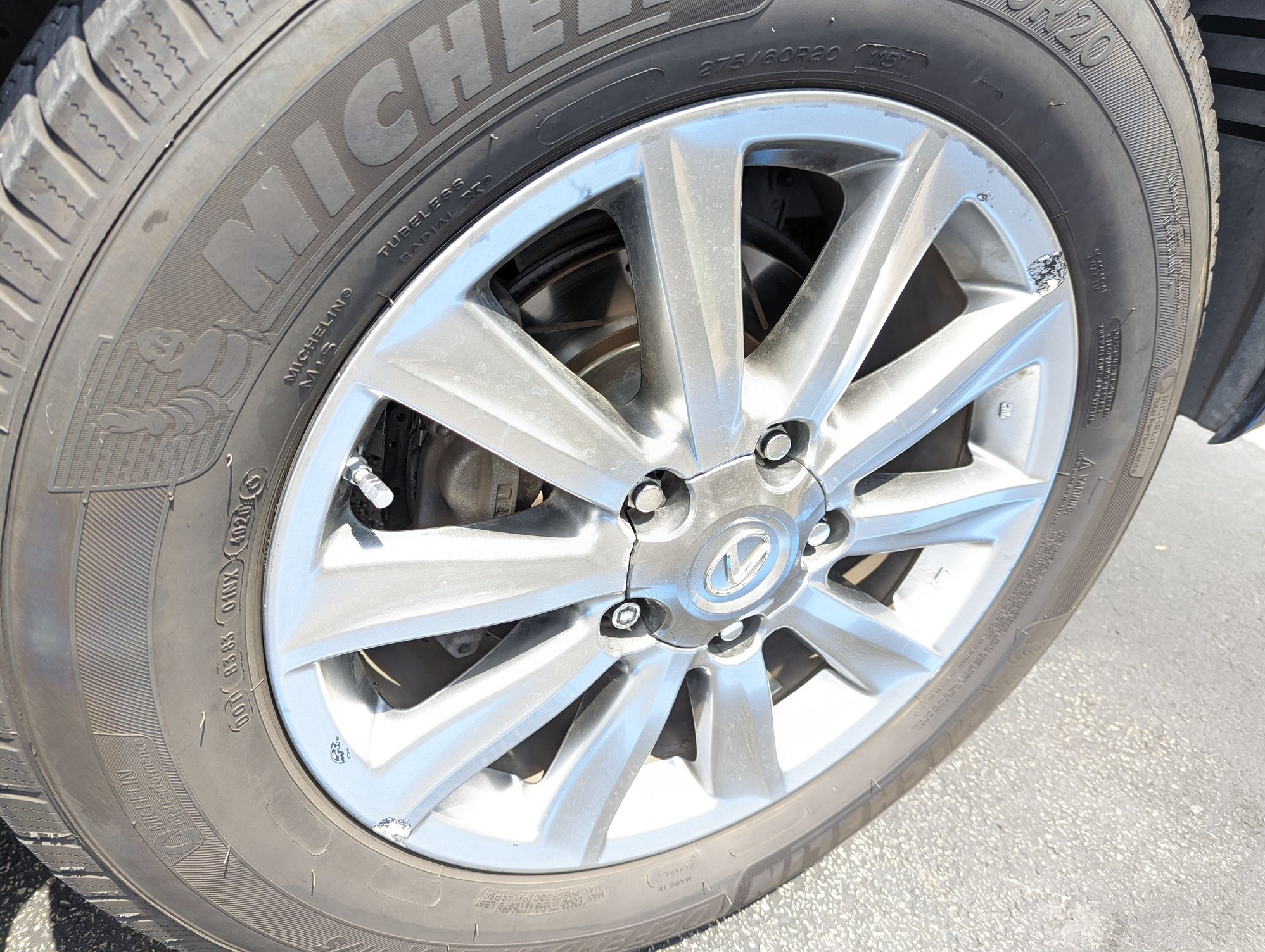

I was looking at wheels the other day to freshen up LEXI's look. But I kept coming back to stuff that looked similar to the stock wheels. So instead I'm going with BORA 1.25" spacers and will refinish the stock wheels. If you're thinking about spacers it's a good time to buy, BORA's are 15% off for the next few days for their holiday sale using coupon code "holiday15" on their website. https://www.motorsport-tech.com
Now I'm trying to figure out whether to refinish the wheels in a color similar to the factory gunmetal-ish color, or go with a different color.
