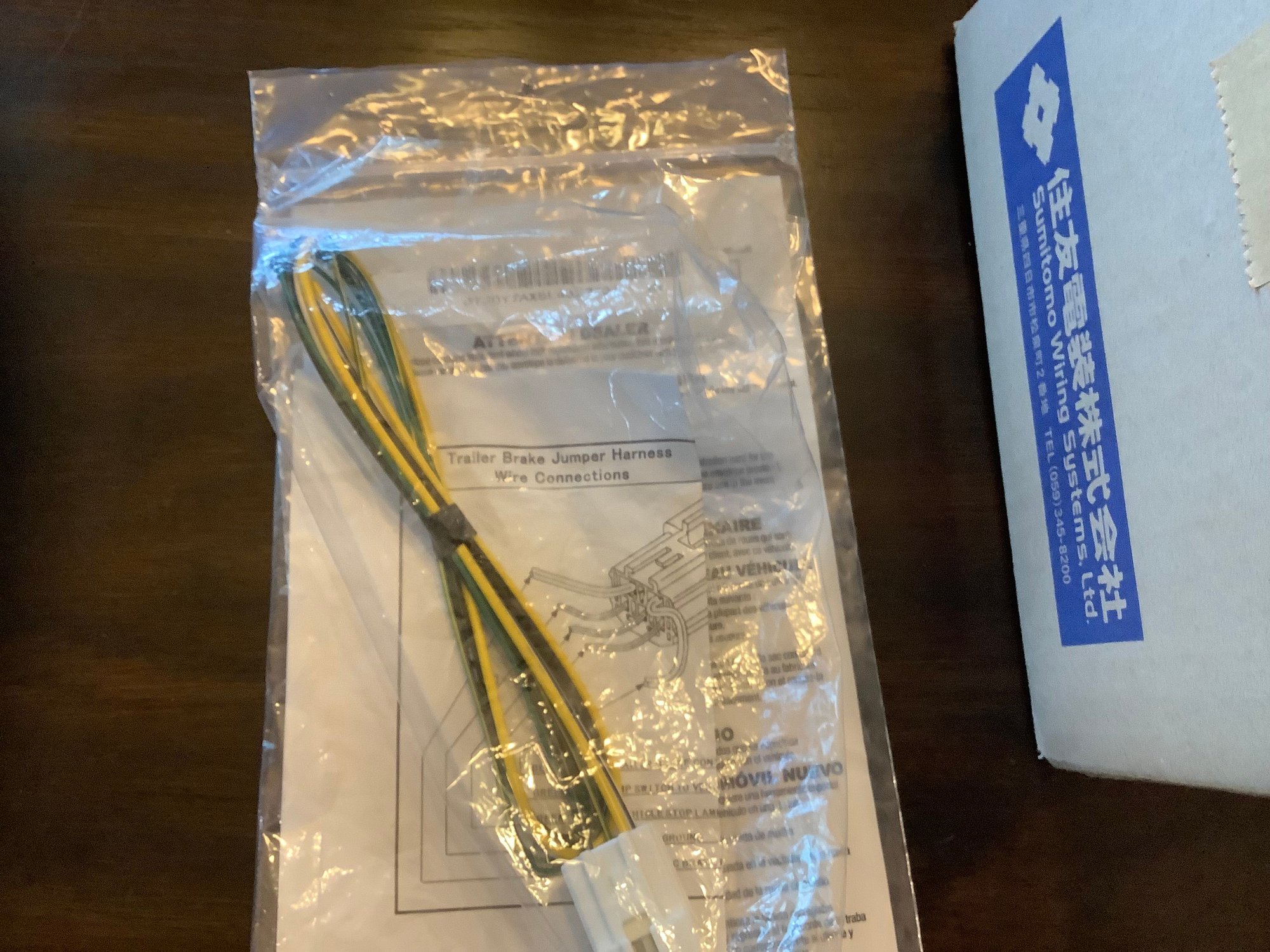

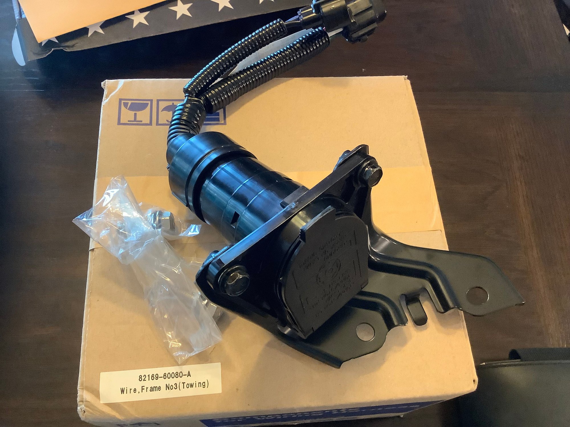

Here are the items that came with my 2020…the dealer did not install the trailer plug or wiring.
Receiver Hitch, no ball
Trailer Brake Harness, I assume it is for the controller.
7pin trailer plug

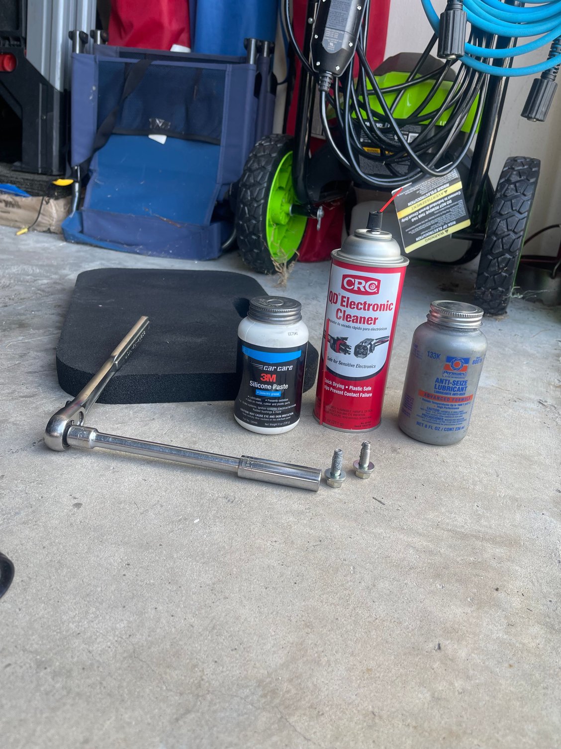

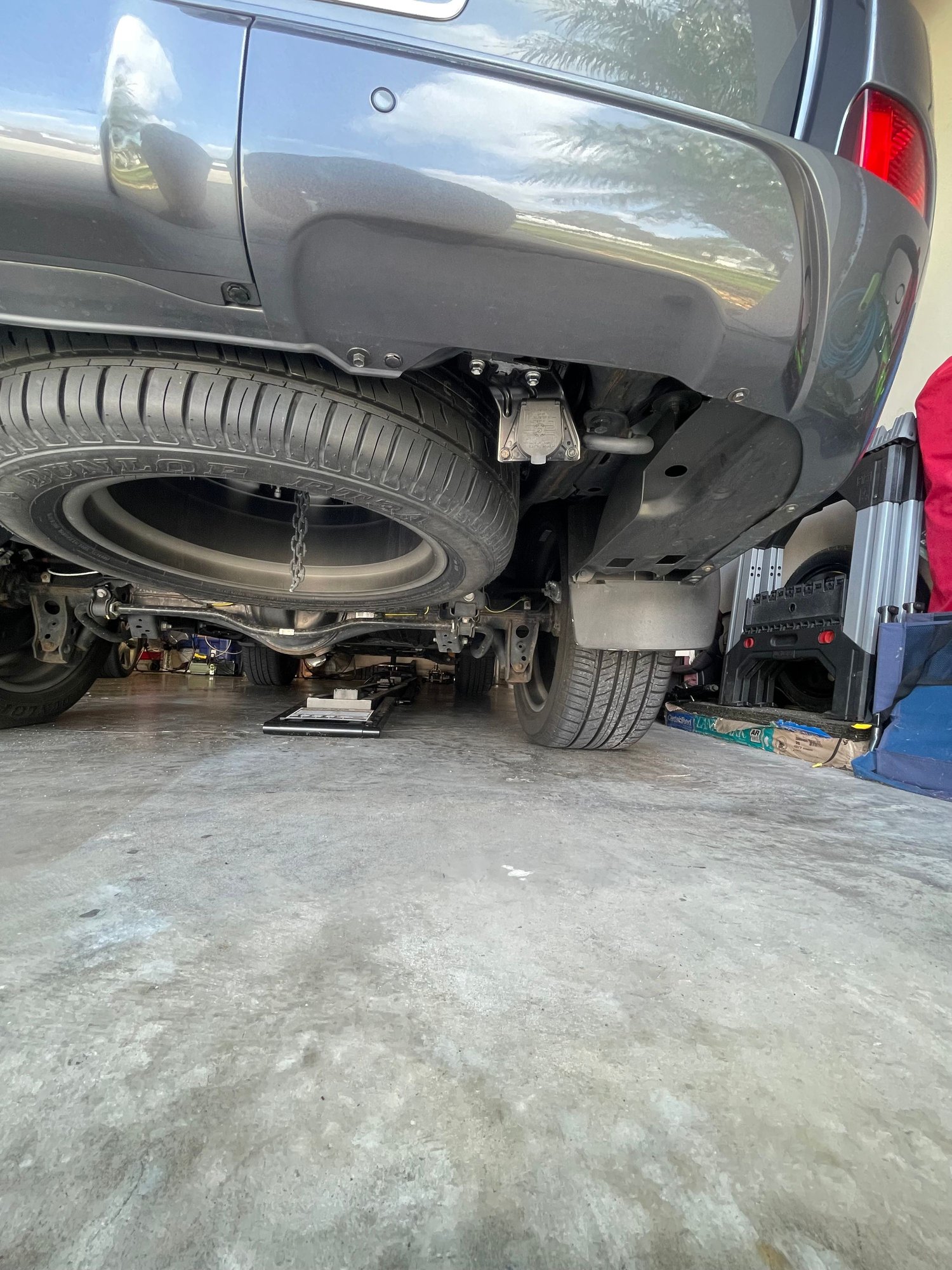

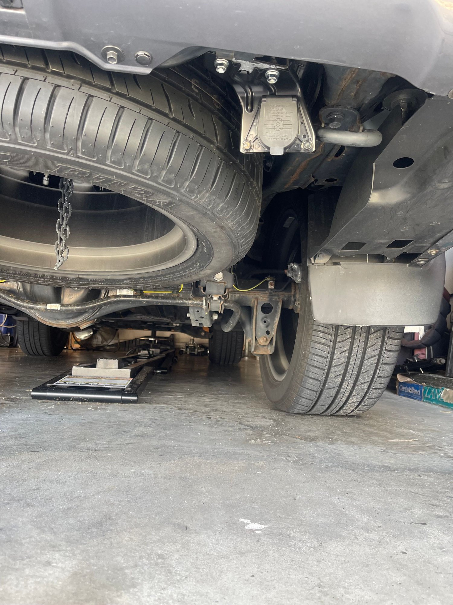

Installed the trailer electrical plug this morning.
about a 10min job
used a 12mm socket.
NOTE: remove the dust caps on the truck connectors.
I sprayed all of the connectors with contact cleaner, then applied dielectric grease.
used Never Seize on the bolts and plug bracket to truck frame mount.

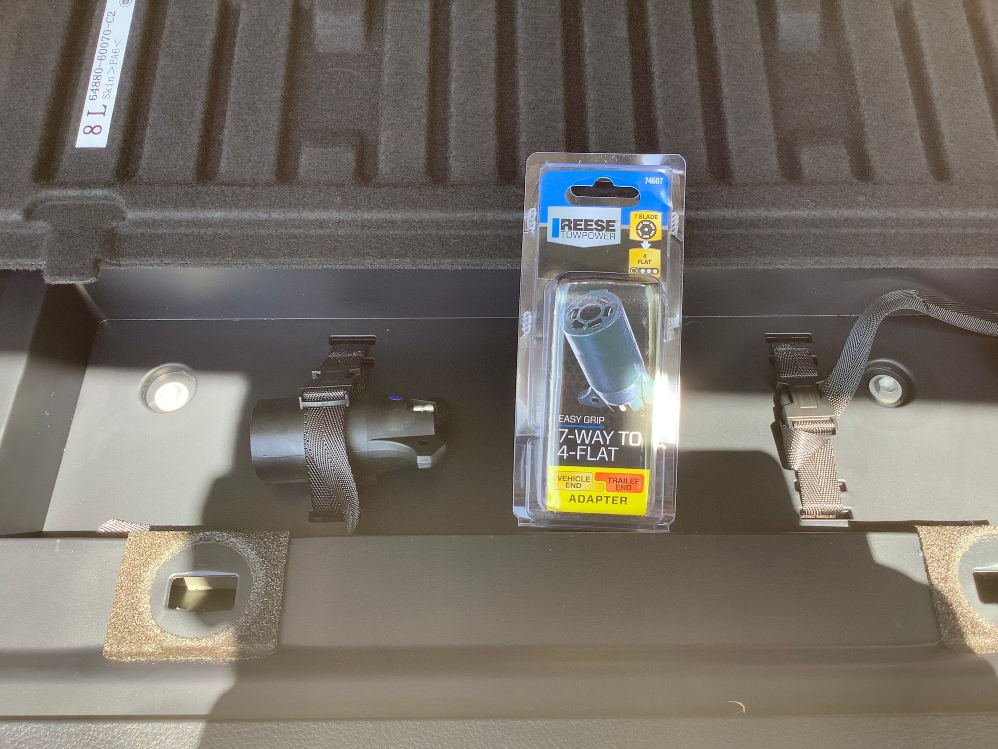

Looks like a good storage place for the 7-4pin adapter

Have you figured out what this one in the picture is for? I have the 7 pin plug installed on my car but don't know what this white one is..
My GX is 16 years older and also have what looks to be exact same thing in the glove box
