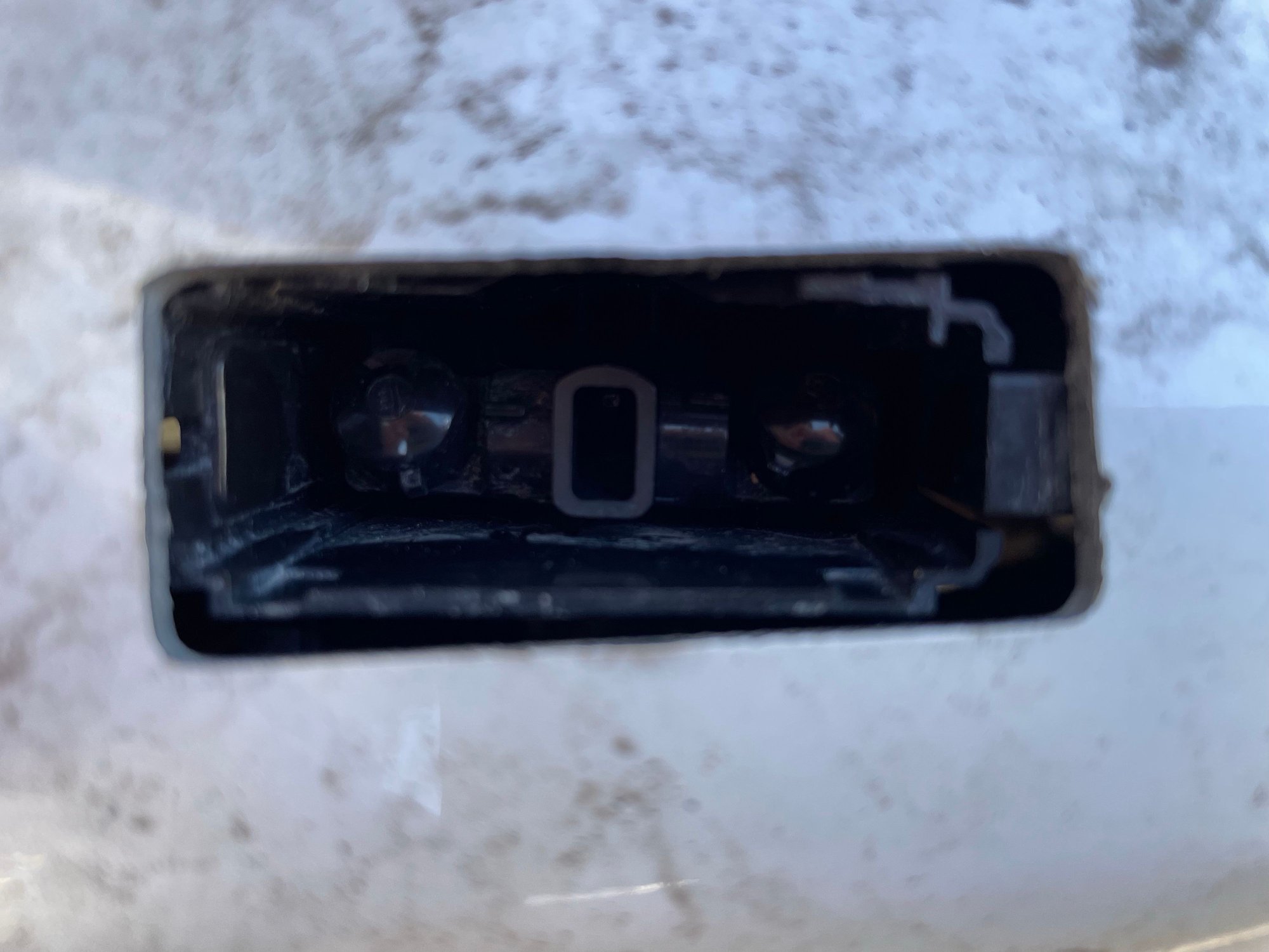

Can someone please help with a part # or a correct parts diagram. I’m looking for the part that is circled in the first photo. It attaches the cover to the washer assembly
The parts diagram that I found online for the LX doesn’t accurate. Part #16 in the diagram is the cover. The Diagram does not show the part that the cover clips into

Its a 2014.
In the vid, I think he is just snapping the cover back into the bumper. Either that or he has the clip that I need already installed on the cover.

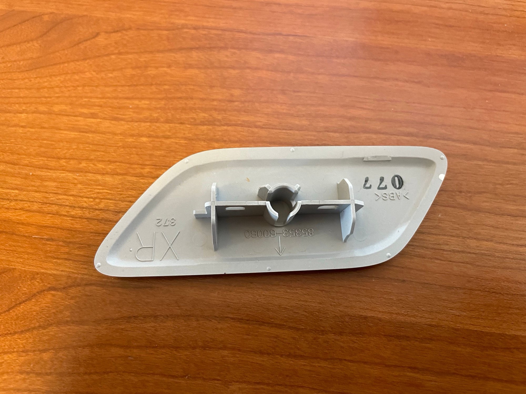

I recently purchased the LX. The passenger headlight cover was missing. I ordered a new one but now realize that I’m missing a clip.
This is the back of the cover.
This is what I’m trying to attach it to. There is a clip missing which is circled in my first post.

See if this helps any…the part number on the back of your cover matches what i see in this link.
I kinda think the part you need might be part of the nozzle assembly, if that is the case, you will need to pickup a used one on eBay or ?
