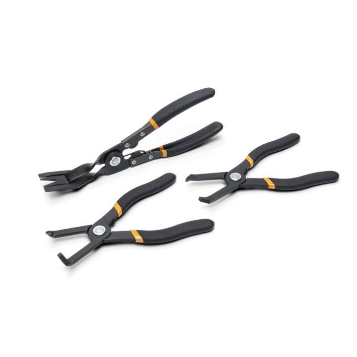

Gearwrench makes a nice set of clip removal pliers. They work well on the hitch cover and the engine shroud clips, and many of the other plastic clips you’ll encounter. To me they are worth the money. I use them frequently, and they beat trying to pry with a screwdriver since the pliers engage both sides of the clip at once and lever it up and out. Part number 41850 in the Gearwrench store. I have been re-using the same pair of hitch cover clips for ten years, since the pliers don’t deform them.

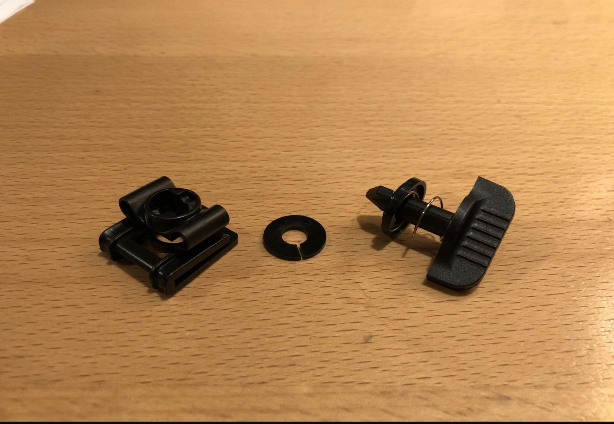

I am disappointed in the design of these clips. Toyota should’ve used a design similar to many other auto manufacturers…
The spring in the pic is a bad idea due to corrosion.
the clip shown is for a Subaru…

Are you saying the clip in the link post above yours is not good due to corrosion? Or that the pic you have here is not good due to corrosion?
If the one in your pic is good please let us know where you got it! Part number?
Tool-free would be best.
I am looking for a solution and this thread would be helpful for a lot of people if we can find something.

Is the clip in the picture above the factory one with your LX. If so mine came with very different clips - simply plastic with no springs. My 2013 clips are very simple to remove and reinstall either with a small screwdriver or the clip pliers I mentioned. And they are totally reusable. I tow both a horse trailer and a 16 foot dual axle equipment trailer so I have had a lot of experience with the clips over the past 10 years.

Sorry for the confusion everyone. I updated my post above to show the clip is for a Subaru.
My Cadillac SRX (Crossover) had a clip similar to the Subaru.
I am going to look for a solution and also want to have a quick disconnect for this cover.
we are going to use the hitch for our bike rack.
NOTE: metal in any clip may corrode unless it is stainless steel or you live in a dry salt free area.

i bought some of those clips above. i do not think they are going to work....needs a rustproof spring in the thing somehow
