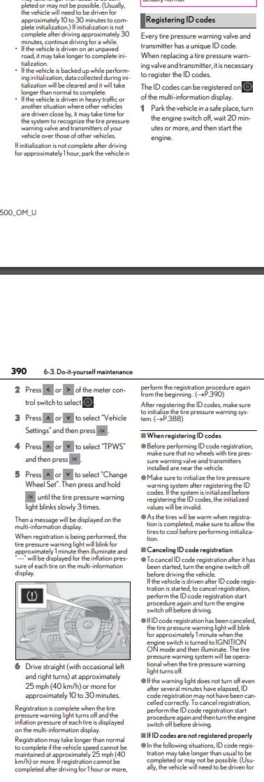

Does anyone know how to register your wheels when you have summer and winter wheels, I thought the LS had the option to register two tpms sensors. might have to look at manual if nobody knows.

Did your LS come with a manual?
