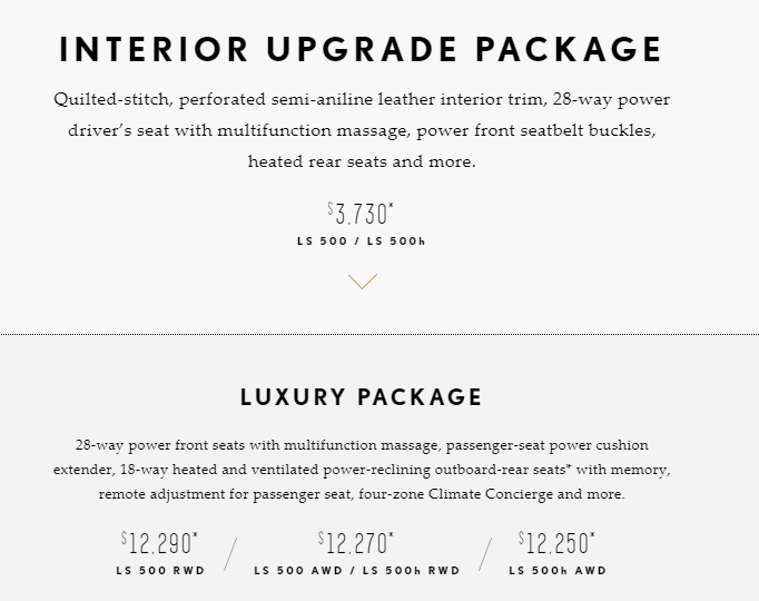

i didn’t think the passenger had a massage option. Which option package does it require?
Old Mar 22, 2020 | 07:51 PM
LexRuger's Avatar
LexRuger
Joined: Jan 2013
Posts: 2,074
Likes: 204
Im pretty sure if the driver seat has massage then the front passenger has massage. The rear seat massage is a separate option package
Old Mar 22, 2020 | 09:48 PM
faifai83's Avatar
faifai83
Joined: Apr 2004
Posts: 1,108
Likes: 34
Interior Upgrade package only has Driver's seat massage.

My bad. Didn't know it came like that
