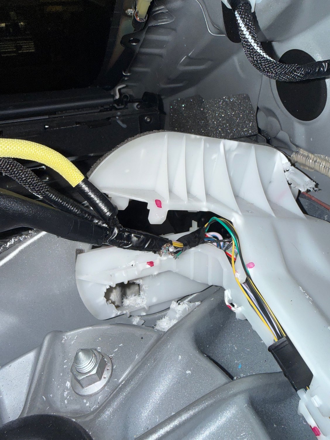

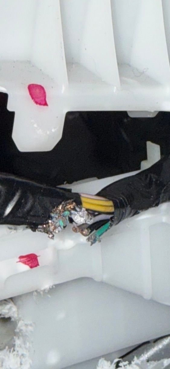

After taking the car to the dealer they determined that the car needed an entire floor harness at $6500 for the part and $6900 to install as there was evidence of what appeared to be a rodent chewing on it

That rat must've been a German car enthusiast. At least it didn't die somewhere difficult to track. Happened to my son with his Camry.
