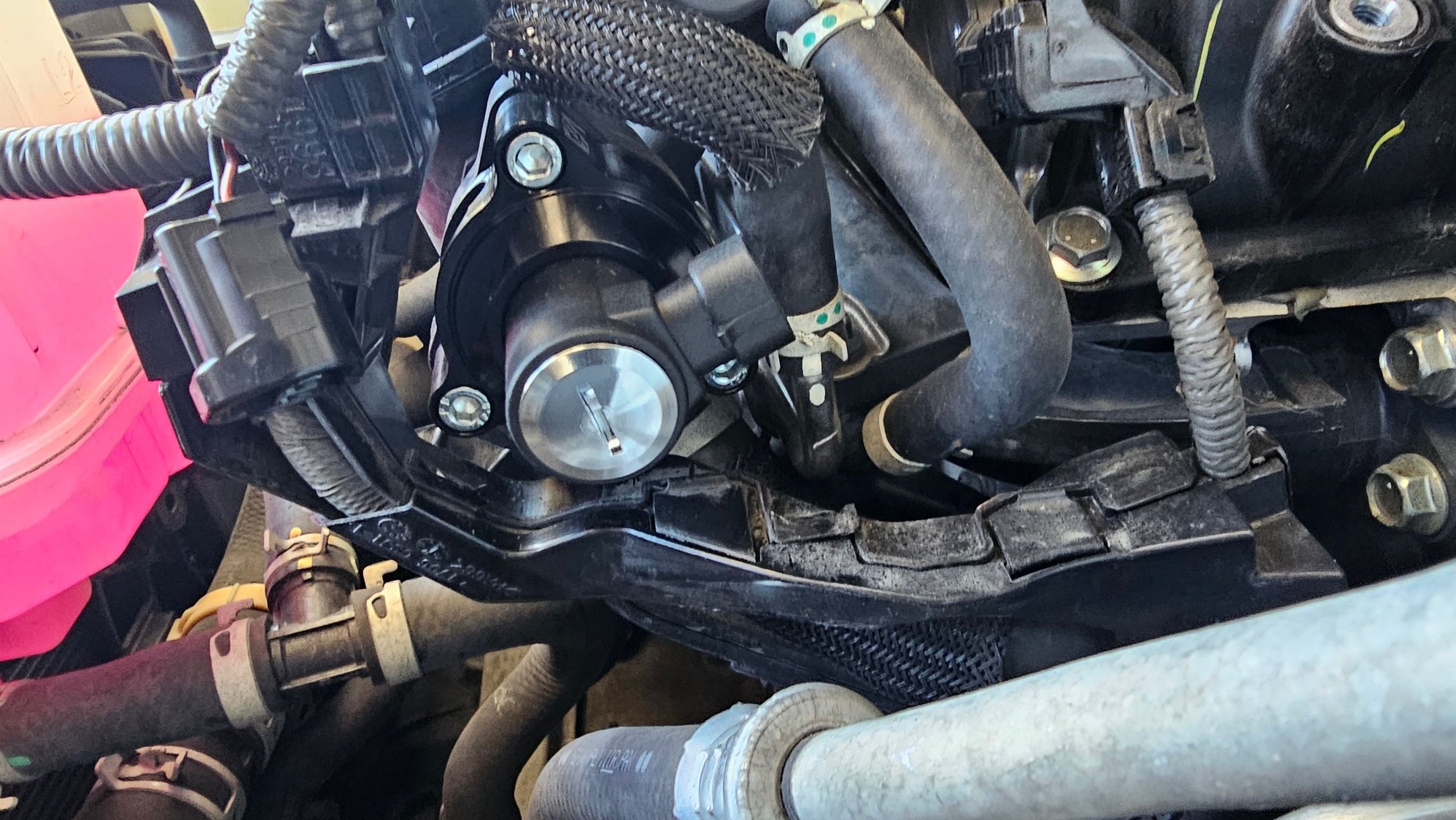

For those who look to have their LS different. Here you go. I did a little bit of homework to find a bov that fits our vehicles. First tried out the BMS bov made for Tundra. Didn't fit but, was okay because my other ride is a 23 Tundra. Did more research and found the Corolla/Yaris GR bov fits perfectly. Ordered a set of GFB bov for the LS. Now I have that pssst sound coming from a Lexus, gotta love it. Everything is a direct fit, comes with a the plug needed.
I need a soundclip PLEASE. Dying to hear what this sounds like...
