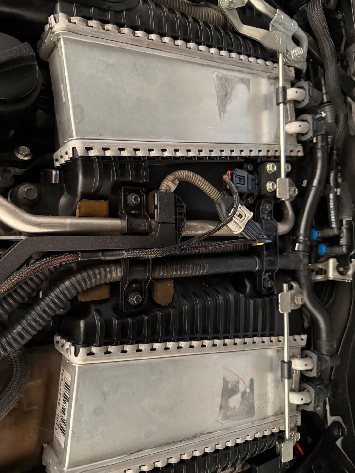

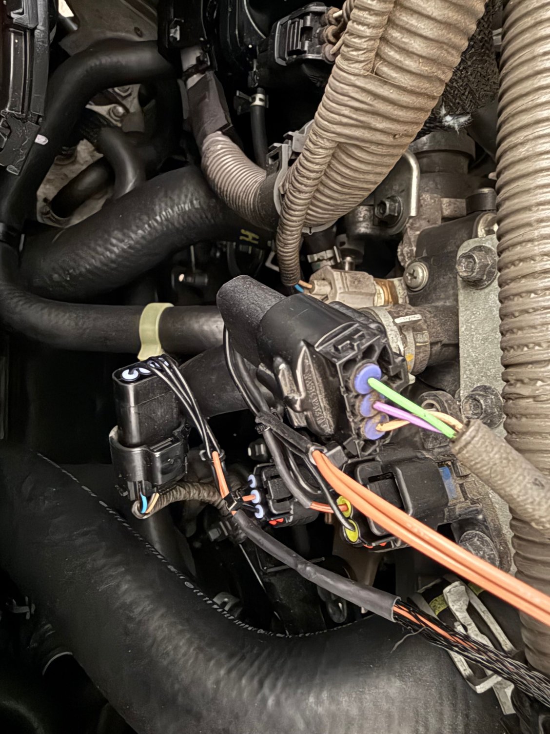

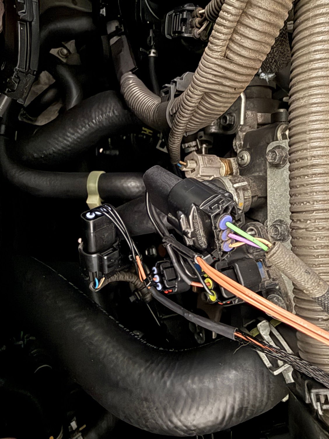

I got my JB4 installed and confirmed by Terry. The installation instructions have different colors, and my JB4 has WiFi installed. I ran a few WOT pulls but only got around 14 psi. I’m not sure what the max stock boost is—assuming around 12 psi max?
