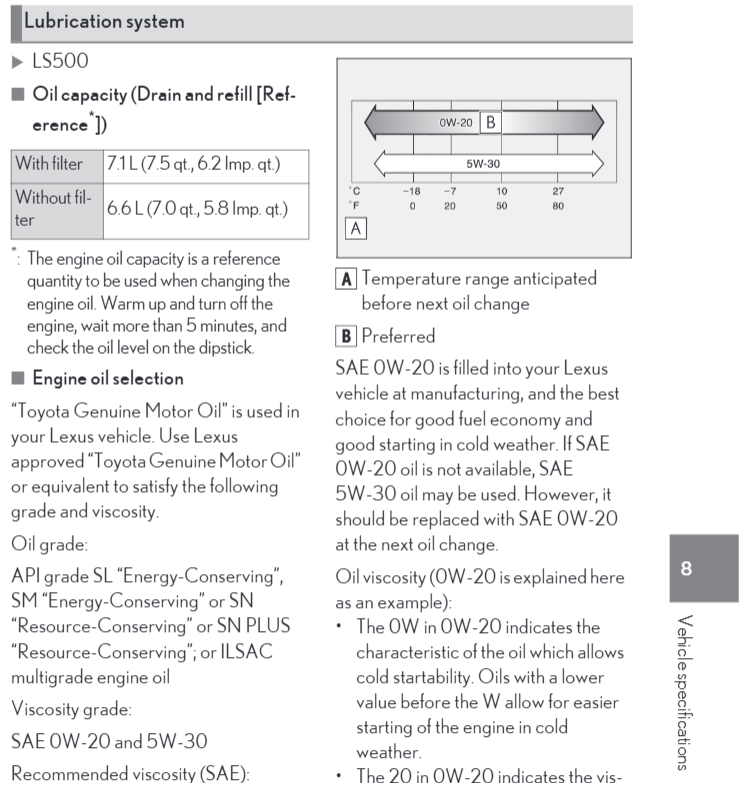

I suppose you could show them the european spec..
Exactly. Why bring it up? And what are the odds?

Originally Posted by LS500zoom
I will show this to the dealer and see what they say!

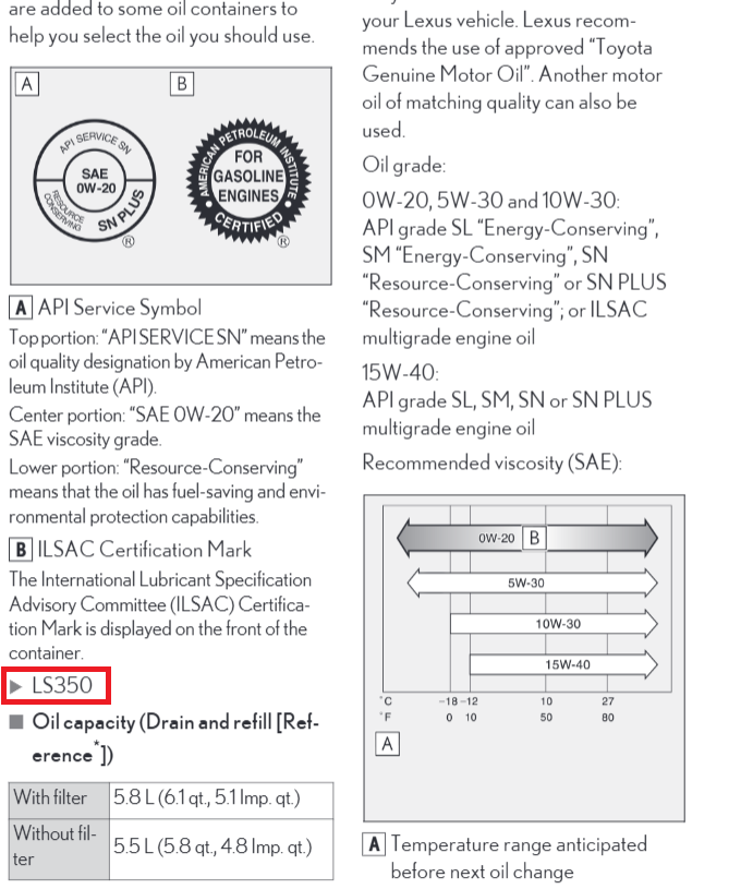

Lexus Europe's owners manual.

There's that. 5w30 again.

LS350.

If it specd by Lexus in one global manual, end of discussion it works and tested.
Just make sure you select the ambient range correctly (ie 0w30 below freezing and above freezing anythingW30).
