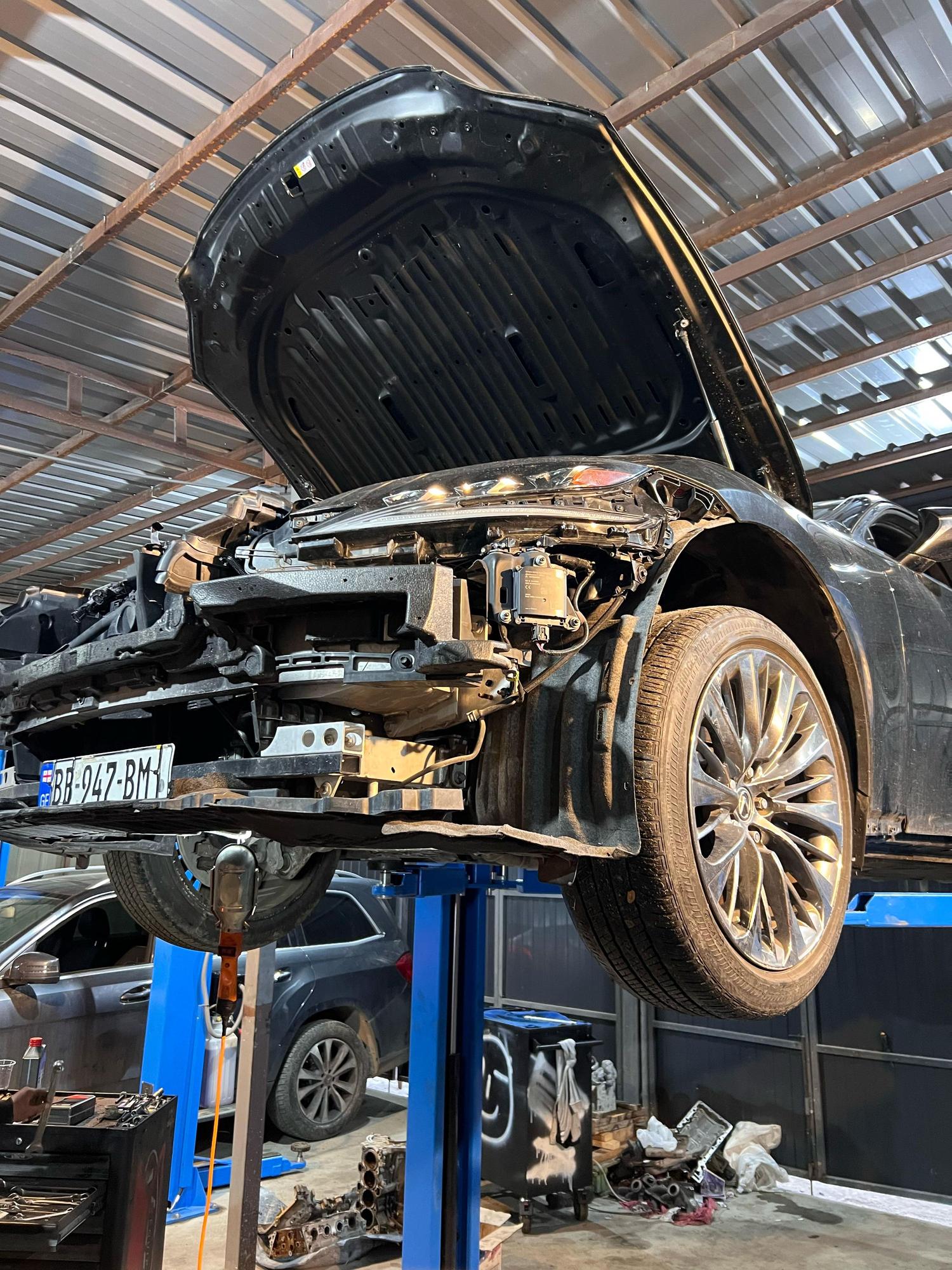

Good Day Everybody,
This is my firts thread on this forum. So, I've got LS500, 2018 which sucked my blood Now rebuilding enigne 2nd time. After first rebuild, idiot mechanic forgot to retighten pipe coming from oil pump, therefore after 20km engine lost oil pressure and crankshaft bearings got scratched.
When we mesured pressure on Pressure sensor spot with manometer, it showed 0.9-1 bar (cold start(. I assume that is too low.
Do you guys know how much normal pressure must be on idle run? Range?

I don’t know what to make of this. Bumper/grille missing, rust. Left rocker panel trim missing. What has this car been through?
I can’t imagine the bill for an engine rebuild. Is this work being performed at a Lexus dealer? From the looks of the shop I would think not.
Yeah, can’t fathom 14 psi oil pressure either.
I would think it should be somewhere between 30 and 60psi.
Thanks for reply Sajack,
Parts are dismantled due to other reasons, everything exist and will be on place.
