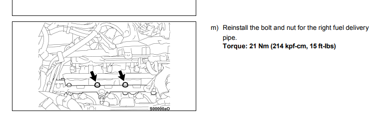

Lube the seals to help with reinstalling the fuel rail into the head, they are a very tight fit. FYI, you have to put a good amount of force when pushing the rail with all 4 injectors in the head. A rubber mallet with very light taps can be used. You can use silicone or stick your finger in a cap of engine oil and then rub it around the injector seals. The rail bolt torque is 15ft-lbs.
https://static.nhtsa.gov/odi/rcl/201...4V647-5234.pdf
