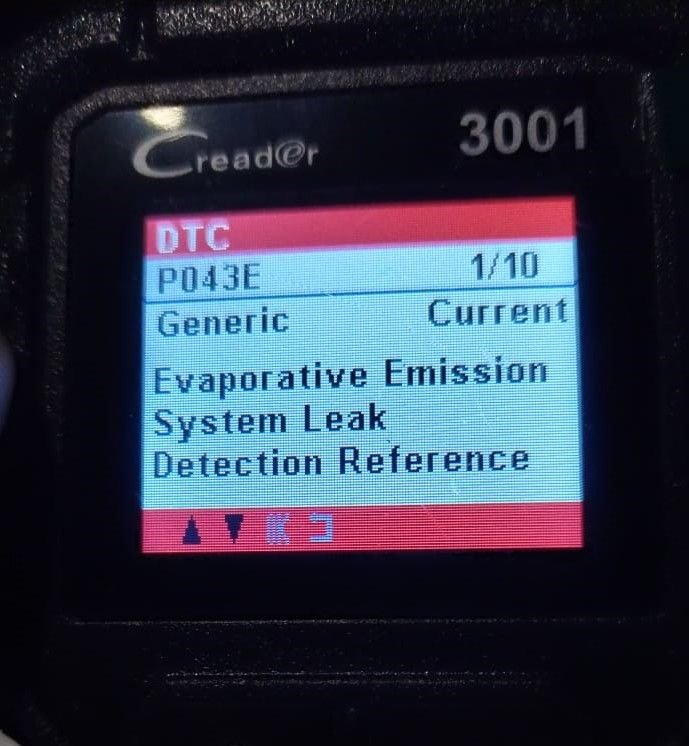

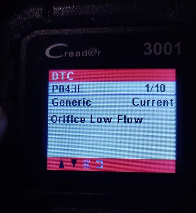

Hi,
Code is 'P043E Evaporative Emission System leak'
attached pic. thanks.
Old Dec 19, 2022 | 02:56 PM
Anfanger's Avatar
Anfanger
Joined: Aug 2020
Posts: 2,859
Likes: 1,004
From: NH
P043E - Reference orifice clogged. Trouble areas:
Canister pump module (reference orifice, leak detection pump, vent valve)
• Connector/wire harness (canister pump module - ECM)
• EVAP system hose (pipe from air inlet port to canister pump module, canister filter, fuel tank vent hose)
• ECM
Sadly, you will need techstream to properly diagnose the issue.
