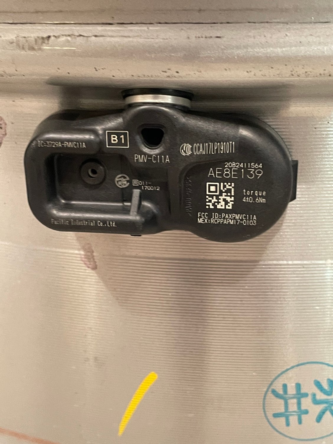

Hi everyone,,
My car is LS460L 2007
I was changed 3 new tpms sensors that was not readings according to Techstream
the sensors are PMV-107J and wrote the ID by carista but unfortunately it’s not working
I checked the other two it is PMV-C11A and it’s working fine
I don’t know why the new one not work because I was bought it by VIN number to make sure I don’t get wrong sensor,,, any idea what I should to do?

PMV-107 TPMS sensors work on 2007 LS460. The difference between no-name (as shown in your photos) and OE (Toyota/Lexus/Denso) TPMS sensors is the lifespan. No-name TPMS sensors like the ones shown in your photos work on LS460/LS460. They just don't last that long. My no-name TPMS sensor lasted only16 months. In contrast, the Lexus original TPMS sensor on my 2008 LS460 lasted more than 12 years. It seems to me that the problem you encountered is that you didn't successfully register the TPMS in the ECU. Most cheap USB OBD2 VCI J2534 cables can only read data but can't write data into the ECU. You need a good quality OBD2 VCI connector for Techstream to register the TPMS sensors in the ECU. I bought several cheap USB OBD2 VCI cables but none of them allowed me to register TPMS sensor IDs into ECU (they could read data), until I bought a VXDIAG VCX Nano cable for approximately $85 (3 years ago). The VCX Nano cable/connector allowed me to use Techstream to write TPMS ID's into ECU. BTW, if you can, use Techstream 15 or newer version, which allows you to enter TPMS sensor ID's all at once on one screen. With earlier versions of Techstream, you need to enter the TPMS ID one at a time/screen within a short allowable time, or it will time out and you'll have to do it all over again. For registering TPMS sensor ID's, Techstream version 15 and above is a big improvement. I'm using Techstream version 17. You may see here for more information: https://www.clublexus.com/forums/ls-...460-ls600.html.
you are right finally it’s work after I go to workshop and use special device to write the ID again
The problem was carista app was not add the ID correctly to ECU and i was leaving the old TPMS inside the car
i use TIS V.17 i will buy VXDIAG VCX Nano cable do u have link or photo for it
Thanks for advice
