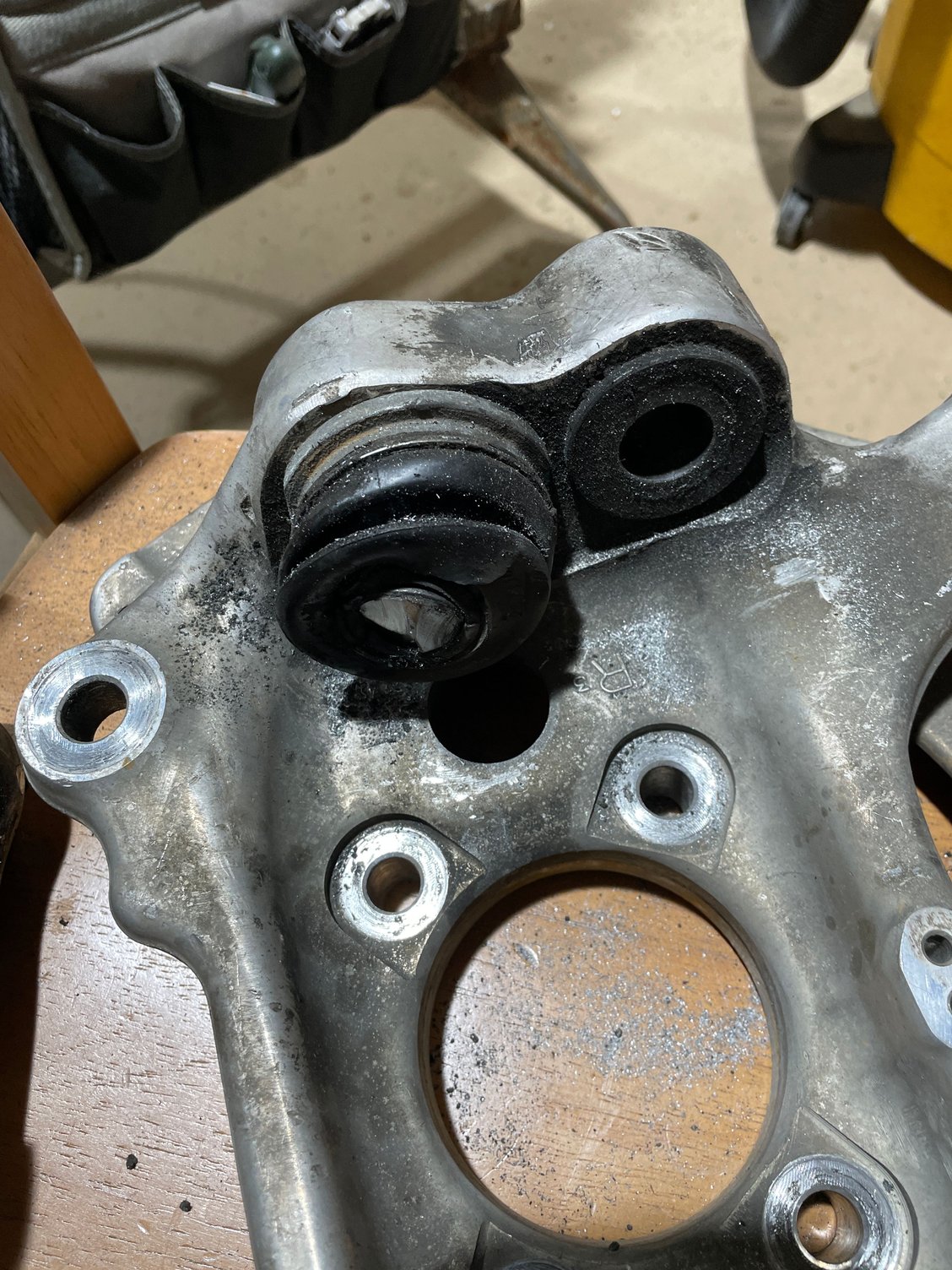

Abject Failure. Bought air hammer bit. No joy. Penetrating oil wait 4hrs. Try again. No joy. Got frustrated and took a grinder, cut the spindle in half since the arm was being replaced.
Castle nut did deform. Tried hitting on the side with no joy
Pressed out the ball joint, and ordered new ones. I have more damn trouble with that ball joint than anything else. My second time to press them out.

Yeah......you are now buying a knuckle most likely, alum doesn't like to have stuff pressed in and out and it will likely be loose. Use anti-seize on everything you take apart and put back since you may be the next guy. Air hammer would have prevented this if used to start with, if you must hit a stud from above use a normal nut that is only 1/2 on the threads to guide the hammer bit/totally guard the threads. It is nearly impossible to hurt the threads if you do it that way

so prep question…thoughts on anti-seize on the ball joint spindle to prevent this next time or for the next guy?
The main issue is due to the use of two dissimilar metals (aluminum and steel). Best to use anti-seize or even grease to provide a thin layer of "protection". I was able to press out both lower rearward arms with no problem. And I also pressed out and installed both ball joints. I placed a thin layer of grease on the inner part of the control arm and did the same on the ball joints.
