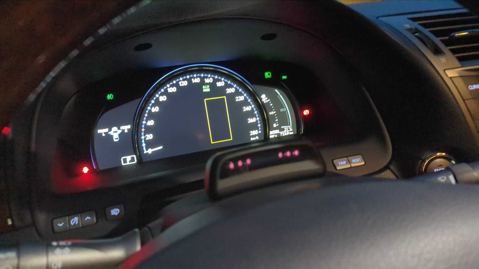

Further progress. Routed wire from glovebox (nv ecu) to the dash. It was rather easy - there's access to dash's blue gvif socket without unscrewing it. Lower cowl off and it's fiddly but doable.
New pic - doing Utility->Manual camera adjust. I still have no cam connected but just wanted to test if the GVIF link is up. It bloody is. Yas. Pedestrian detection reticle is applied by ecu (not dash) and sent via gvif video link.

Testing. It works.
Am I feisty and relentless or what.

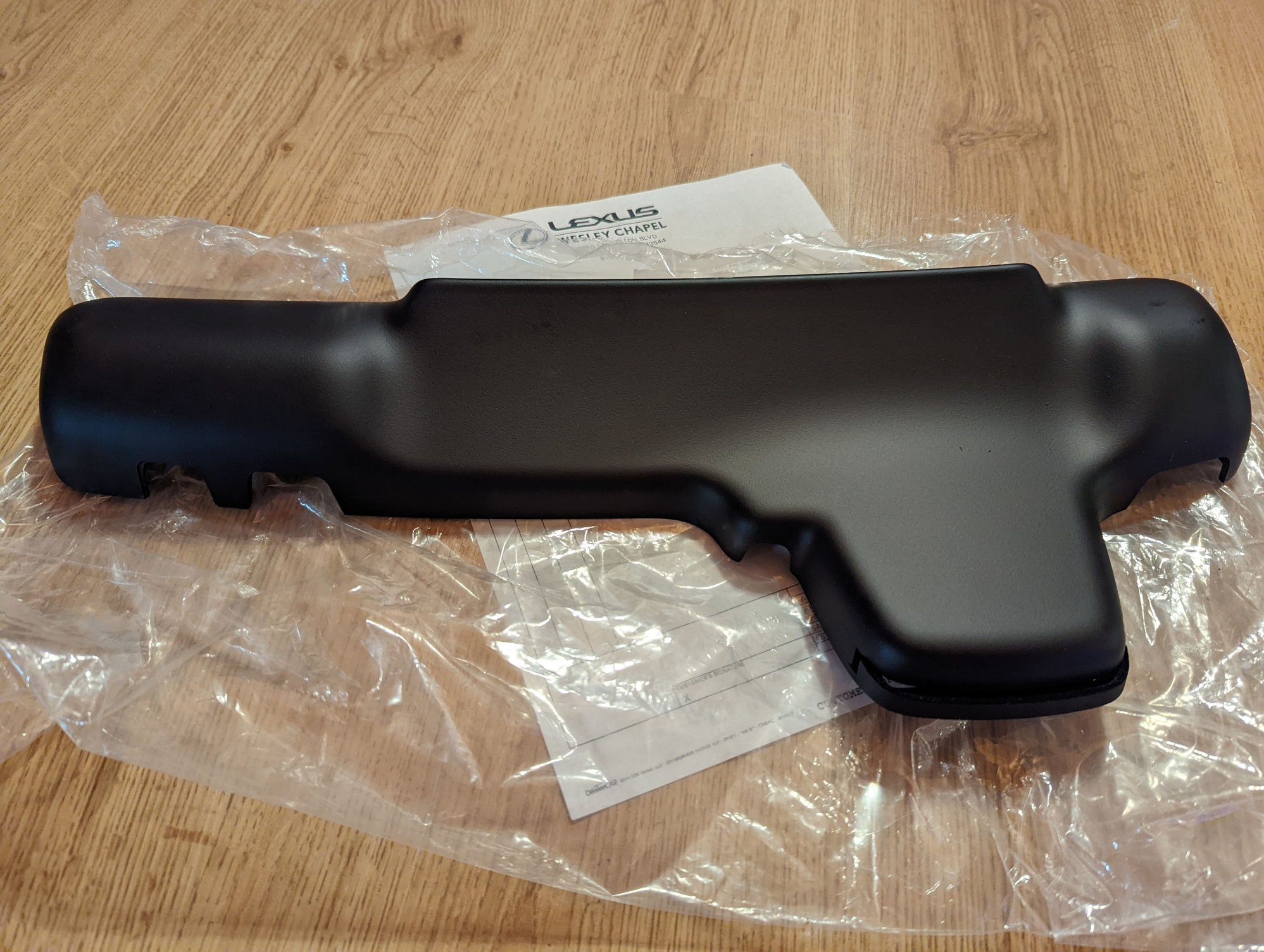

Okay, little interim update here. I've managed to source cam cover from 10-12, it will accommodate lka+nv cam nicely, will just have to dremel out a window for nv (easy, factory contour marks).
Thing is, I ordered one easily via parts.lexus but it got stranded in transit... I went back to get another one - it's now discontinued across everywhere. Had to use dealer network to order _last one ever in existence_ (not my words). So I got last two covers ever (well, backorder still works with timeframe 180/350days) in existence. Hoarding eh haha.
But it's the final piece. It's coming.

Oh yas, good times. It's finally here. And after some careful dremeling I now posses an unique part - 10-12 cam cover with extra NVcam opening.
Extra props to Wesley Chapel Lexus for sourcing this gem.

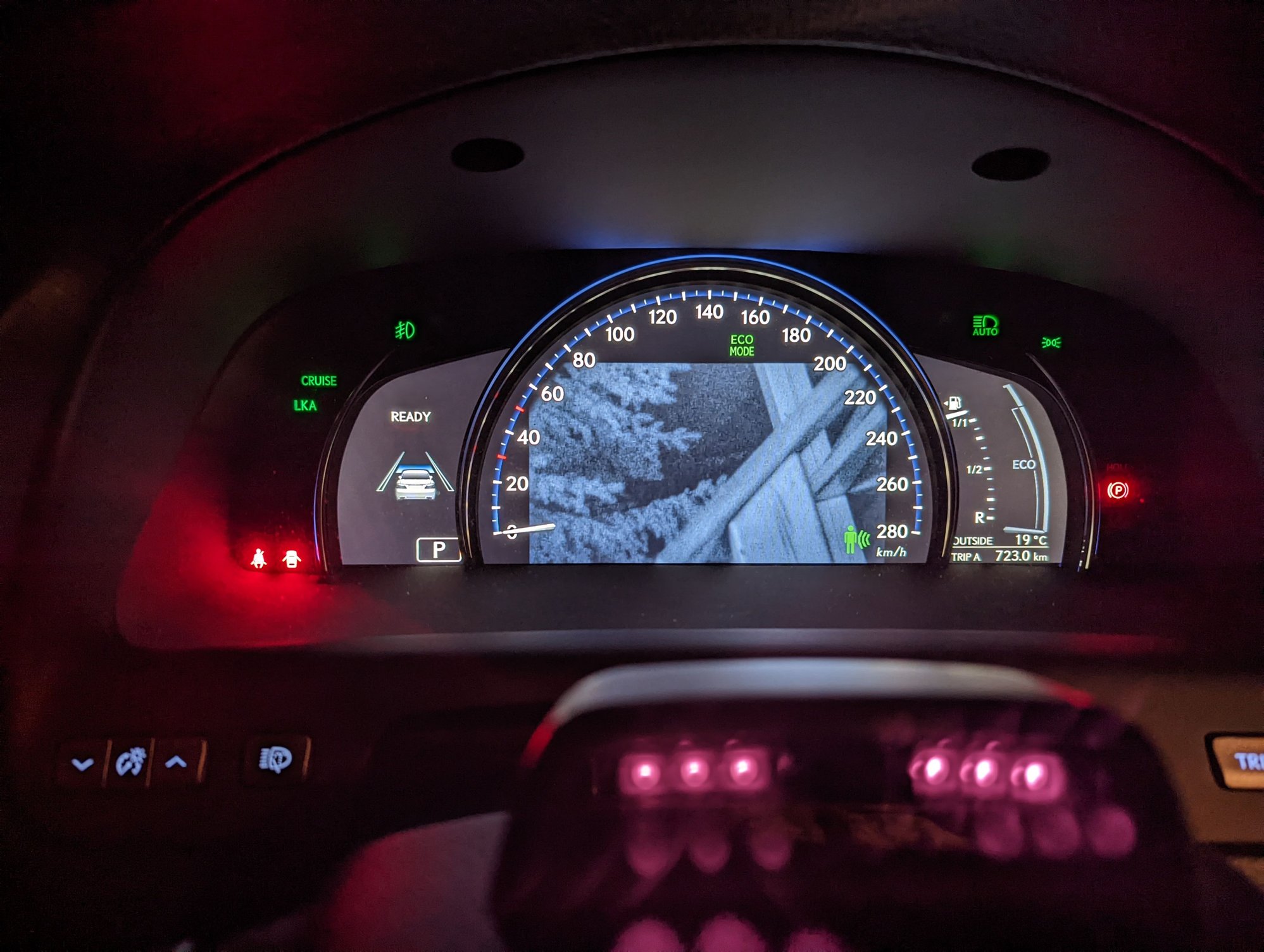

I'm doing it right now. Roof cut added, 3-eye cam installed, cover in, handmade harness routed via right pillar to the glovebox. Looks great. LKA recalibrated to pair new cam, all good, no problems.

And it's done. It's too dark outside to perform proper NV calibration (with tripod, target, etc), so I just selected 'manual adjust' and clicked next several times. And lo and behold. 'Cam not initialized' DTC went away and it started working.
Off to test drive, will try to take some sizzling pics.
