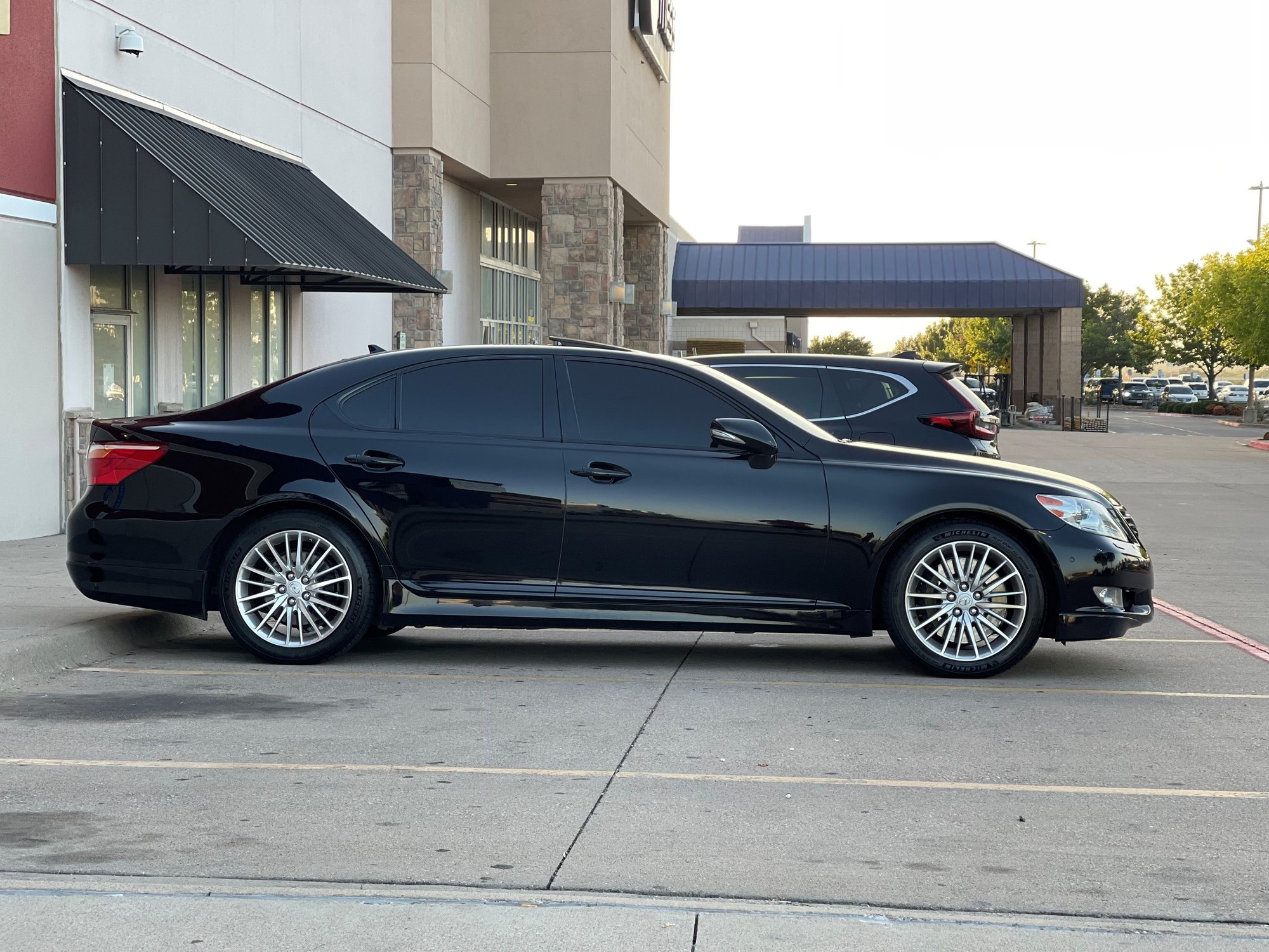

(edit) Is this ceramic coat in the picture? The paint looks awesome.

Not ceramic coated but its on the list!
