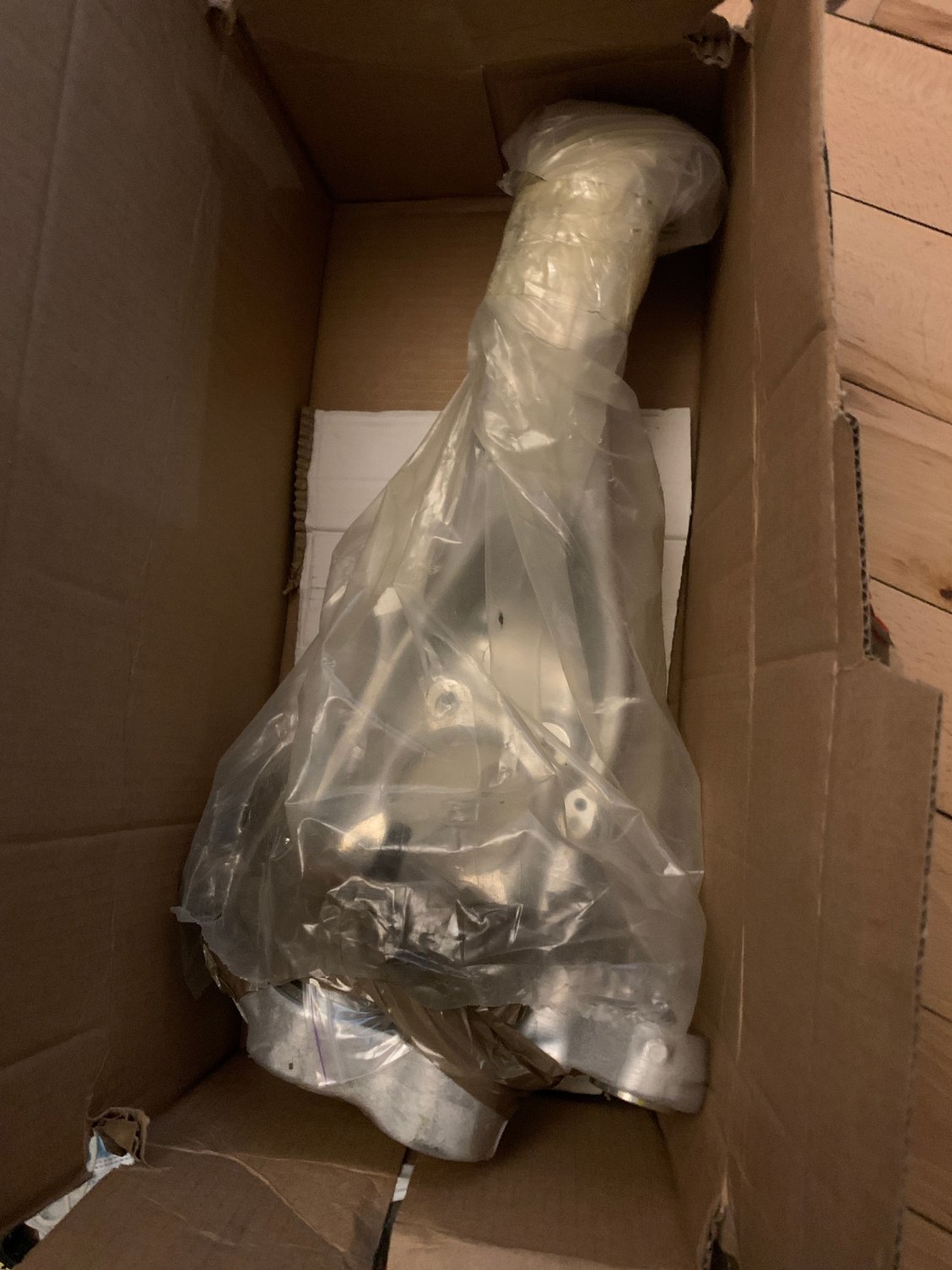

Mar 22, 2022 | 01:45 PM
No it does not come with the wheel hub/bearing you wish for under 400 lol
i got mine locally new prob last one in this country for 290 USD. Everything else needed to be ordered from abroad and cost 100-200 more than what 1 paid.
the wheel hub and bearing I’m going with koyo which should be 100-150 usd.
