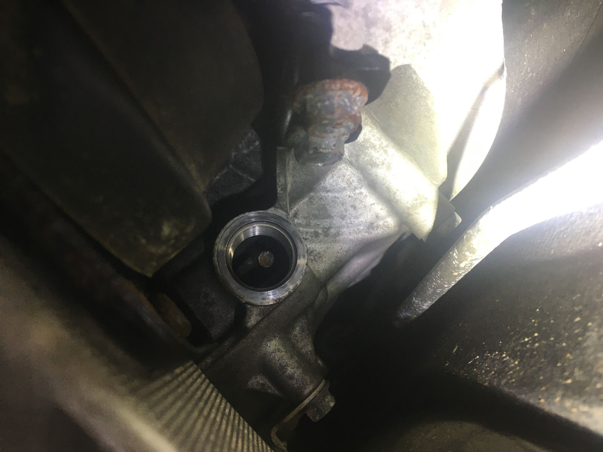

I was at the shop far too long today. Oh and an item of advice/something I have found, it's far easier to add fluid from the rear service port. Much much much easier to open and get to, 17mm Allen bit is required. A long type (4-5 inch) is needed and you have the perfect angle around the exhaust to get to it. It uses an O-ring and is very nice vs using the 24mm side fill. Just so everyone knows.....I'm having a fun time with learning this new car!
Bottom view of the rear port
Inward/toward view of the plug from the rear of the car, very easy to access even if you don't have a lift IMO. I may be completely wrong though since I have only done this on my lift
