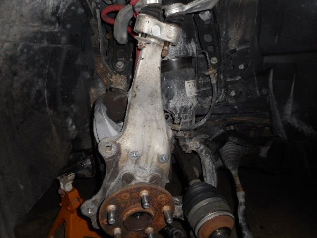

Thanks Anfanger & Striker 223 for your suggestions. I have been looking at the Amazon OTC kit and also thinking my 1 pound dead blow hammer is way too small.
For the moment I got around the problem of freeing up the upper control arms, I just let the steering knuckle hang out of the way of the axle shaft.

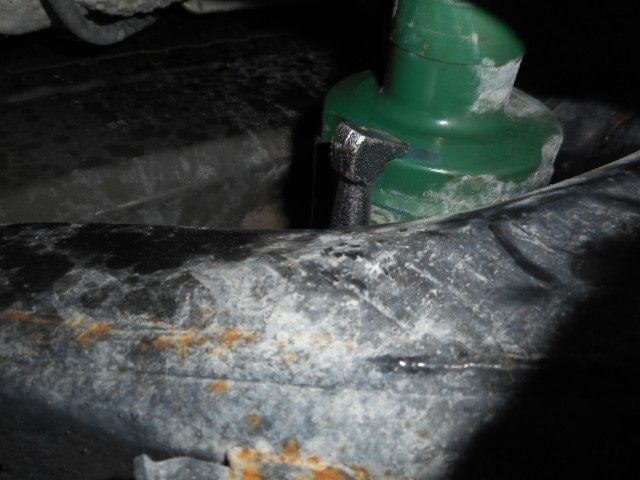

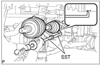

So, I think that means I'm ready to remove the right front axle. The shop manual talks about the using a slide hammer and hook and I'm pretty sure they mean for both right and left axles. I have this ready to go including a nice hook from Amazon. I have it arranged about the only way I can make it work which is not exactly like the shop manual. I've hit it a few times and nothing is budging. So thats the first question ... Am I doing this right?

That is not a control arm. It is an axle. You need a sliding hammer with a hook, at least, it is what I used. I provided tools I used below including brass punch set.

If it is the right axle, it is much harder to remove due to the bearing. I have done only left side.

Just to close this thread, I didn't buy a removal tool (yet) but I did complete the install of new boots for my RWD 09 axles. I wasn't able to extract the complete right side axle and had to instead separate the inner axle from the outer by separating the tripod joint. That actually went pretty well but then later I had to re-join the two axles and with them in position, I had to get the inner boot on and captured by the crimp type band clamp. I bought some really nice crimping pliers from Amazon called Knipex, they made it easy....Arnie
