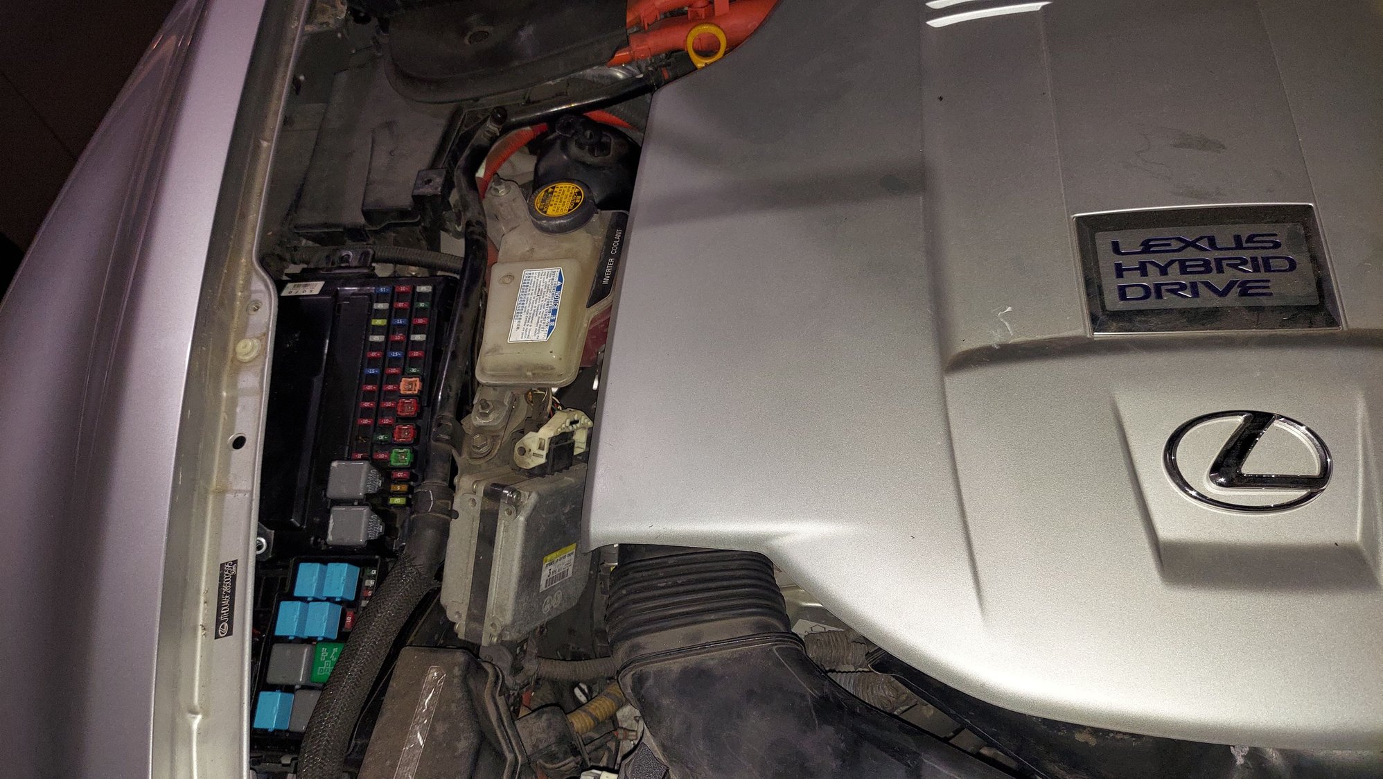

Any helpful hints how to remove this fuse box? Edit: found this https://www.clublexus.com/forums/ls-...he-fuse-2.html
Edit 2 : This box is a royal pia to change on a 600. All of the components to the right interfere with removal. ( inverter coolant line, coolant container, power steering module, ect.) I ended up unbolting all of them to gain an inch. I also unbolted the fender for some more wiggle room. Then you can barely access the electrical plugs on the bottom. I used a long flathead screw driver to release and pry out the difficult harness plugs on the bottom. Both headlights now work. Swapping the box did the trick. My hands took days to recover :/
I have it unclipped. The fender and other items are in the way. My right headlight is not illuminating. Swapped headlights over from gold car and it is still out. I'm assuming the non serviceable headlight relay in the fuse box is bad.
