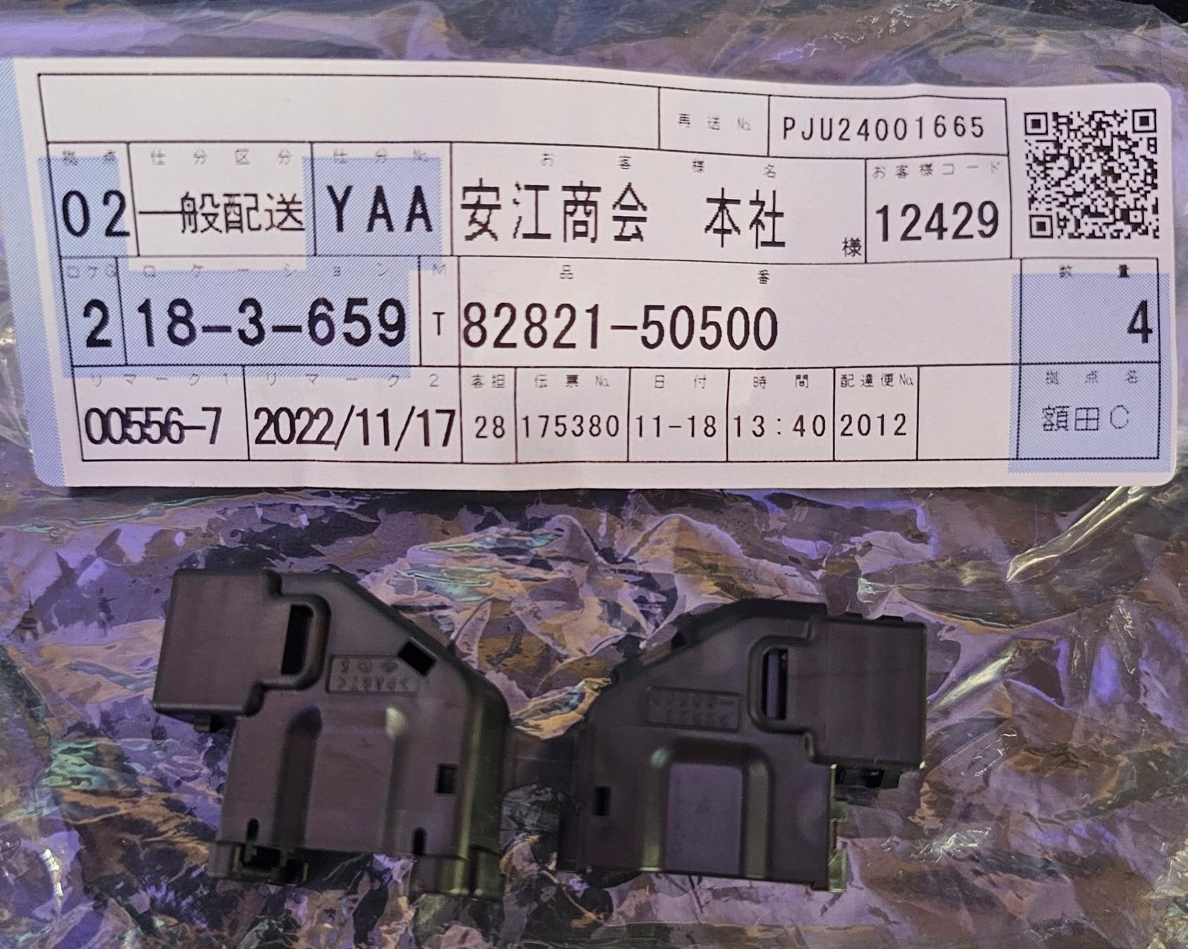

Originally Posted by ALK
You could always change the connector with a re-pin tool and new connector P/N 90980-12292 .
I agree 100%, people can do whatever they want on their own cars. Doesn't work that way when you work on others vehicles...first of all as witnessed on many posts here people don't want to pay for parts that were broken while the car was being worked on/why should they right? Then you have to order the part and wait a day or 2 and try to get the car back in and lose that time and probably the cost of the part because why should they have to be inconvenienced and then have to pay on top of that ???

The part number is on the connector. I replaced both the connector and 90 degree section on each sensor. The connector falls apart so it is easy to get the wires with the pins out.

Here are the part numberts.
Did it not come with the wires?

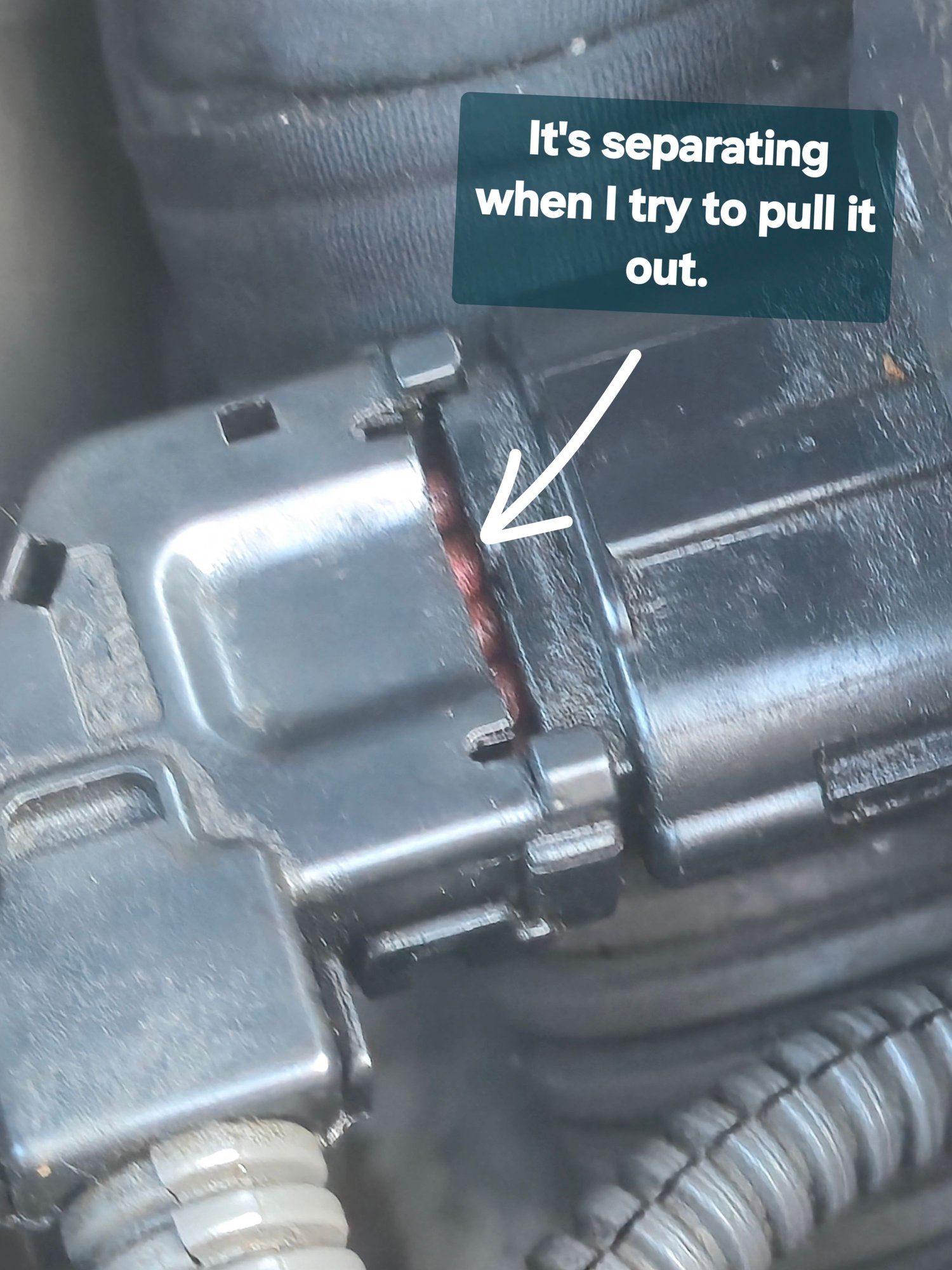

Originally Posted by Allusuc
Hi all,
I took the engine filter apart this weekend and while doing so, it seems as thought I might have cracked the harness that connects to the mass airflow sensor. It’s not the sensor itself but the small clips. The clip is still attached, but a small part is obviously cracked. Wires seem to still be fine. Should I be concerned? Anyone else have this issue while squeezing and disconnecting the harness? It looks like it’s hanging now on my car lol
I’ve attached a pic of the area that was cracked (this pic isn’t the actual condition of my car, found this online but wanted to pinpoint the area).
I have the same problem going on. I got a faulty MAF sensor code & replaced the MAF sensors. Now the engine sounds like it's running fine & it's not in limp mode anymore, but the check engine light came back on & gave me a P0171 code(air leak). I'm wondering if this could be the connector making it do this. I'll send a picture of what mine looks like.
It's a lot worse than this now, too.

Default Replaced the MAF sensors, but now I'm getting a new code. Could it be the connector?
I'm having the same problem. My car went in limp mode & wouldn't come out of 1st & the code from the check engine light said it was the MAF sensor so I bought 2 new MAF sensors & replaced them. It drove fine after that on my way home from the shop after installing the new MAF sensors. I stopped &got gas & everything with no issues. A couple hours later, I got in my car & cranked it & noticed the check engine light came back on. I checked the code and it was P0171, which is supposed to be an air leak or could be due to a faulty MAF sensor, but I just bought 2 new sensors. The connector is starting to separate though & I'm wondering if this is the problem, now.
It looks like a lot worse than this, too. This was before I installed the new MAF sensor.
Wondering if I should just replace the connection or what?

Thanks for the part numbers. Just ordered.
The connector is $11.xx each, right angle fitting is $3.xx each on Bell lexus website.
