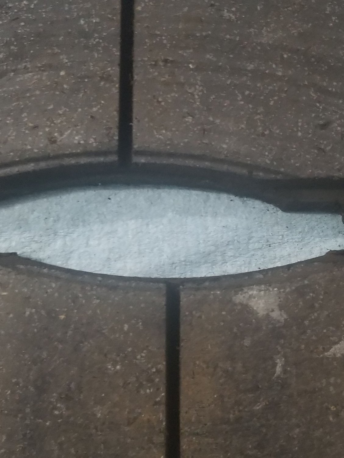

As you can see there are multiple scratches in the pads as well as deep grooves. While I don't doubt that a flush is long overdo the rotors and/or the pads didn't perform up to par. I started getting the vibrations while braking a couple weeks ago and quickly got worse. I already had the rotors on the way when my starter died. With the new rotors and pads the problem is completely gone.

I replace them with a set of power stop pads that I purchased on closeout from RockAuto. There was a closeout deal on them plus I purchased front pads for the GS as well as getting and rear door the 400. The old pads were still at 3/8 of and inch in one side and a little less then that for the other side. I made sure to check the pain boots for any tears and they all looked good but I might pull the new pads and give them a closer inspection. The old pads looked really glazed over.

Even at 50k you can see that I still had plenty of pad material left and that's because I hardly do any braking let alone heavy braking on the highway. Maybe my expectations for these rotors are way too high but even the stock rotors lasted till 100k.

My OEM brakes had plenty of pad material left at 26k miles but they were noisy and shuddered and warped. My 2015 was the same way, so for me the OEM rotors didnt last past 25k miles.
"Lasting" is a relative term. They could have been buffed or resurfaced, but rotors are so cheap its just not worth doing that really.
