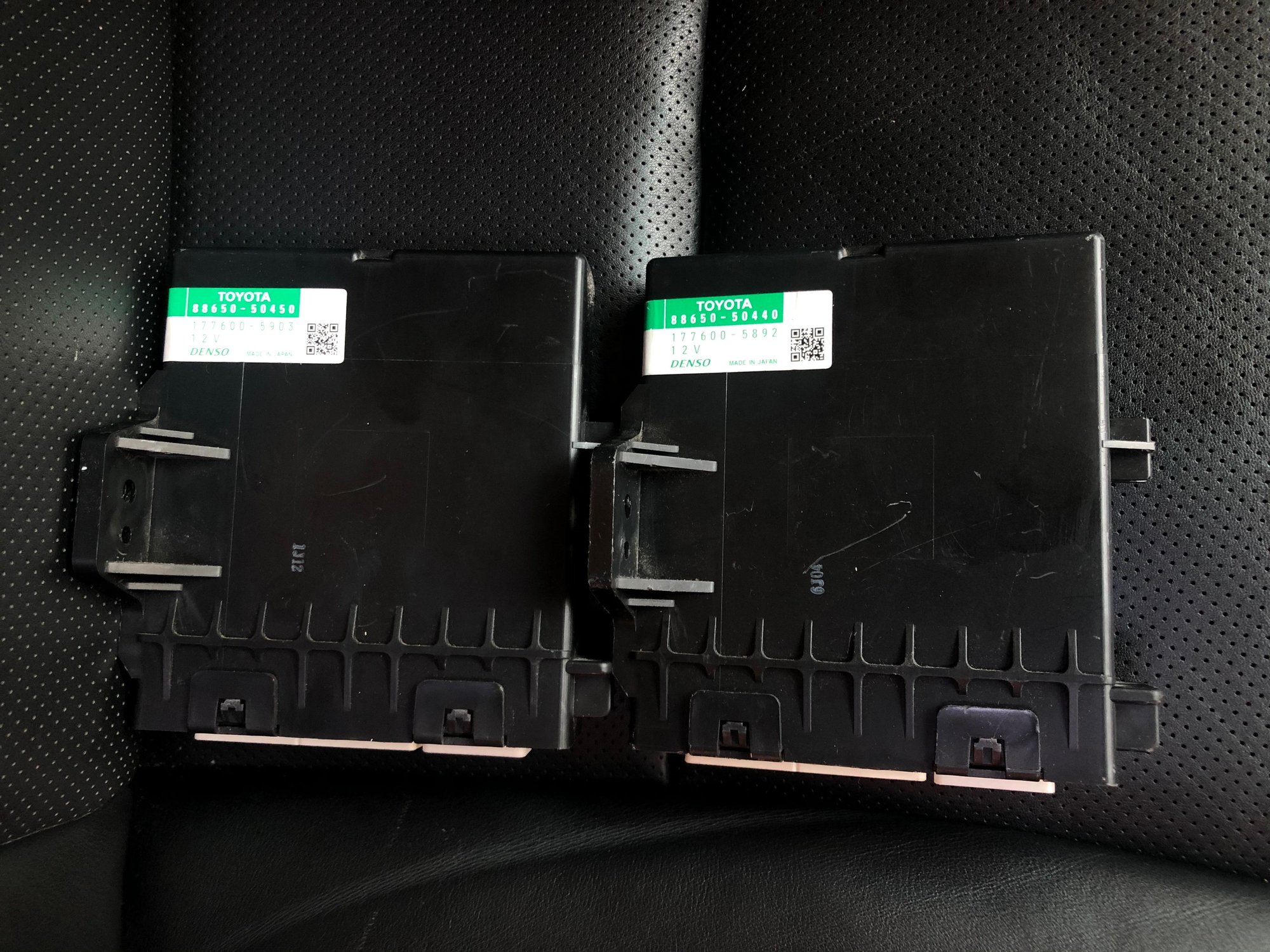

I received the used amplifier I ordered from eBay and swapped it out. Turns out that I got the wrong part number-- it's for a SWB and I have an LWB model(did not have the extended climate controls on the touchscreen when you go to the climate settings). Part number I ordered was 88650-50440 but what I need is 88650-50450. Can't seem to find it anywhere so I'm going to see if my mechanic can source it or just find out how much Toyota has it for. My only concern is that when I swapped it out, there was still a delay in the AC startup. Not sure if the amplifier I got is bad as well or if it's because I got the wrong part but I'm hoping it's either of these or else I have a different issue than what others are experiencing.

It's hard to say you may have another issue. Is your blend door opening and closing normally when you view it in the glove box? I've read that can cause the delay if it is not functioning correctly. I'd probably still try the correct ac amp first.

Blend door functions normally, swapped out the filter not too long ago and made sure the blend door was in the open position before attempting the swap. Yea, when it finally turns on, it either starts up at 75f or "air conditioning off."
Got a quote from my trusted mechanic for the part I need since I can't find any used ones online. It's no longer available at Toyota and it is special order from Lexus for $650. Wasn't prepared to shell out the cash since I'm not 100% sure the amplifier is really my issue so I'm going to try pick-your-part to see if I can find a cheaper replacement.
