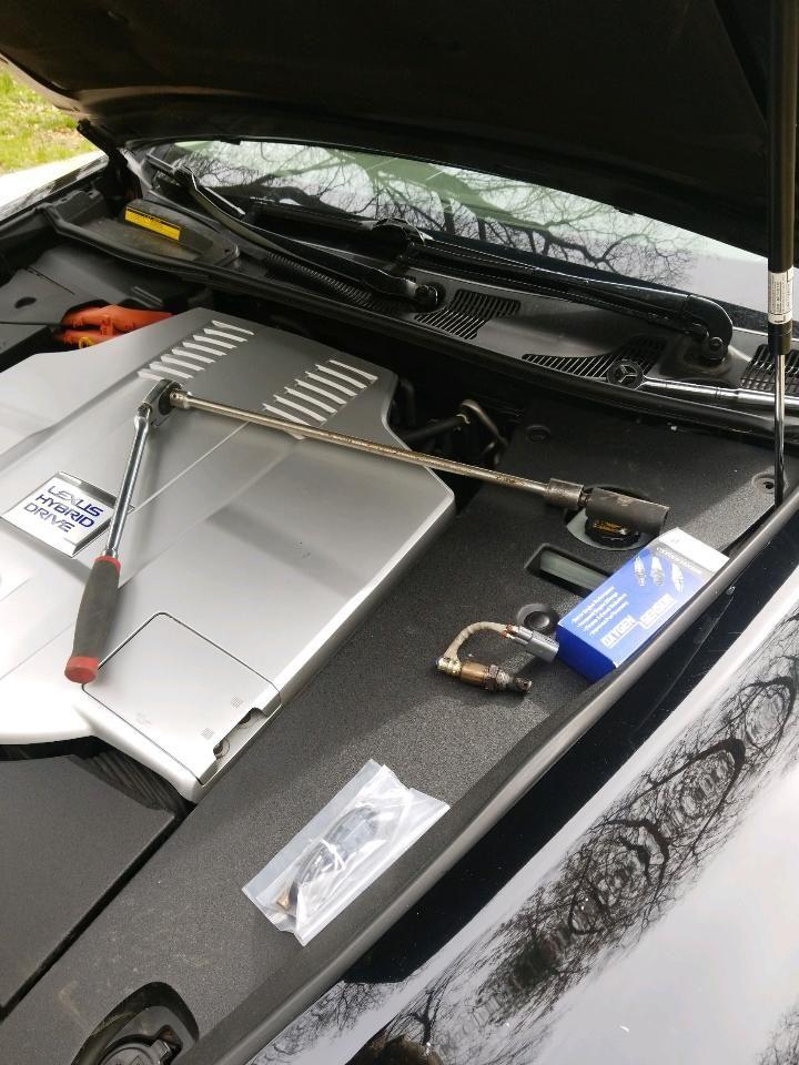

You should get rid of the car, it’s not for you. Sell it to somebody who can handle it.
Lots and lots of unhelpful information in this thread.
The factory service information says 20.0 hours of labor to replace the upstream O2s. Engine and trans are supposed to come out. Thats unreasonable to anybody who is not a Ferrari owner, and a legitimate concern for most of us.
Im going to attempt it next week, either pulling the manifold or the exhaust. Usually thats not an option on a Michigan car.
Edit - went out to take a look. Left side, b1s1 was accessible from the top. didn't even take the engine cover off. Took about 15 minutes, mostly getting the tools out.

Originally Posted by sha4000
lots of unhelpful info here too. Your a year late and didn't even provide info on how you got it out from the top.
Of course you obviously removed the covers and most likely the battery and tray but you didn't state that so everyone is left guessing.
A year late for the OP, but not for the people like myself that use the search function to find answers to common questions.
I used a O2 socket, a universal joint adapter and a 12 inch extension with a nice long ratchet. It moved, but was stiff, so a squirt of PB.
Plug was easy to get to, but had to be released one handed..
I did not remove a single cover, or the battery, which is in the trunk on a 600.

The O2 is straight down in the hole in the left rear of the engine. The O2 in the pic was a cheap sensor I had that fit, but didn't work. It needs the right a/f sensor ill get tomorrow.
I used a O2 socket, a universal joint adapter and a long extension with a nice long ratchet. It moved, but was stiff, so a squirt of PB.
NICE!!! good to know it can be done from the top also. Thanks for posting your findings
