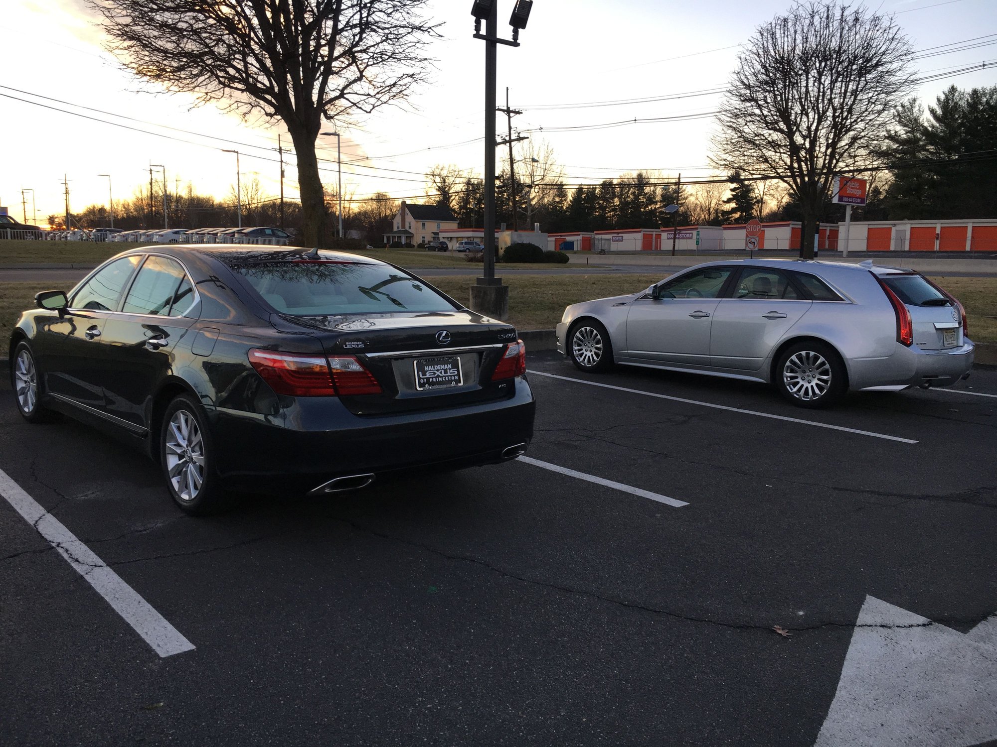

I switched from a wagon too, and I do occasionally miss being able to fold the seats down and throw my bike in the back. The LS is a much nicer car than the CTS, though.
The LS and the CTS the day I traded the wagon in.
