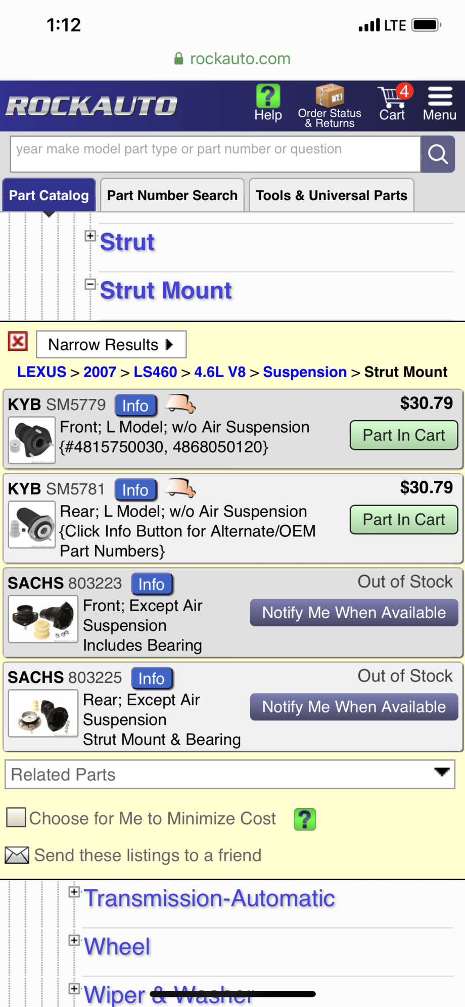

Will these KYB strut mounts work for my 2007 Ls460
Old Oct 18, 2019 | 01:14 PM
Sportznuts's Avatar
Sportznuts
Joined: Mar 2007
Posts: 355
Likes: 42
Default Will these KYB strut mounts work for my 2007 Ls460
I don’t have the ls460L. Is that what they are referring to when they say “L Model”?

Anyone? Trying to order parts as soon as possible.

Do you have AIR struts? If you are on normal metal springs, the KYB parts work fine. I just installed front and rear on my 2007 LS460L.
As an aside, there is also an upgraded front spring for the 2007MY car that includes a plastic cover to eliminate a noise over bumps. It is possible these upgraded springs also have a slightly higher spring rate.

I have the base model. No air struts. It looks like these mounts are for the L model. Seems like the base model KYB strut mounts are more expensive than the L model. Weird.

I believe they are all the same. The way the description is written is confusing but it just means that the strut mount fits the base vehicle or the L version without AIR suspension. I have used these parts on my LS460L without issue. KYB is the OEM manufacturer.

Thank you. It is confusing. It’s possible the L is from
the 4.6(L)
