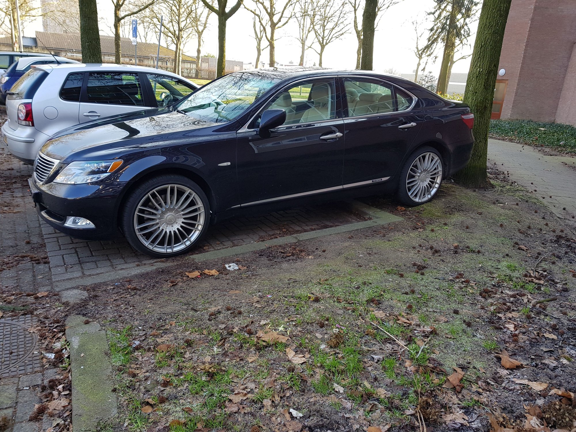

I had 245/35/21 on my 2009 600h, i hated the ride, it was too bumpy so i changed them to 245/40/21. The speedo is now exact and the ride is much smoother.
No problems in corners or over speedbumps with my OEM air.

245/40/21 front and rear.

Rears look like they can fit even larger tires. Not sure what the next size up is. 245/45? 250/40?

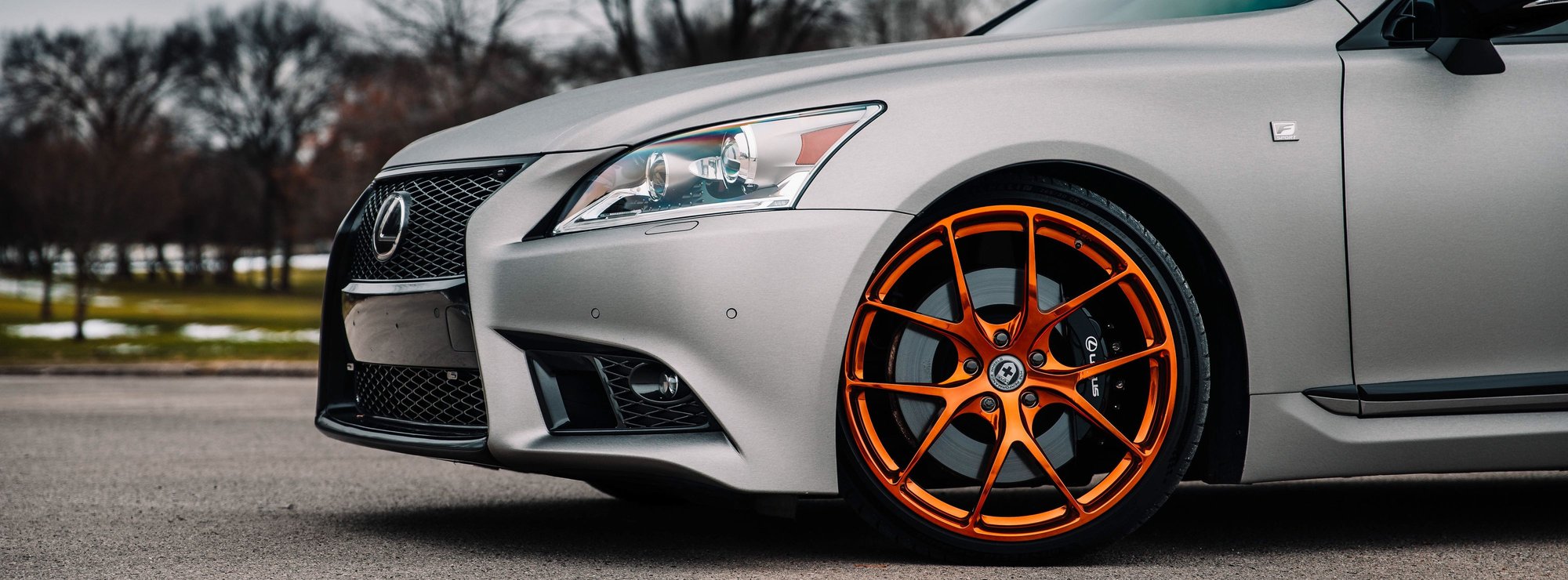

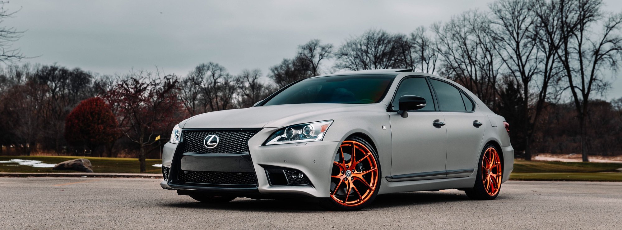

265/30/21 HRE P101
Old Sep 30, 2019 | 09:54 PM
3GSShoe's Avatar
3GSShoe
Joined: Dec 2016
Posts: 471
Likes: 74
From: New Mexico
Originally Posted by PRSUIT460
265/30/21 HRE P101
I haven’t seen your full vehicle. Did you black out your chrome trim along the doors? Or is it black chrome?
Old Sep 30, 2019 | 11:14 PM
PRSUIT460's Avatar
PRSUIT460
Posts: 1,467
Likes: 16
From: Wisconsin
It’s gloss black vinyl

Just some reply from my side:
@Higgie,
We already had contact on the Dutch forum, you have all the same size wheels around, where I would like to get the rears wider. Maybe I have to let my idea go and also put all the same sizes around, since not every tiresize is avalible and I don't want different tires in the front and back.
Regarding The Netherlands, my car gets parked in my garage, parking garages and or open spaces so not so much curb problems.
@sdl s,
English is not my native language, but these notes in my original post provide the answers on your question:
- Is the car still comfortable to drive with 21'' wheels. It is my daily and family car and don't want it to get uncomfortable
- My LS 460 has air suspension and is on standard height, so I also don't like anything to rub, nor do I want to change something at the fenders and or suspension.
Next to this I see a lot of secondhand 22'' wheels for sale, which tells me they are too big and give too less comfort.
@prsuit 460,
First of all your car looks stunning, I guess however you also got it lowerd. You even have less tire on the rims if I see your tiresize.
