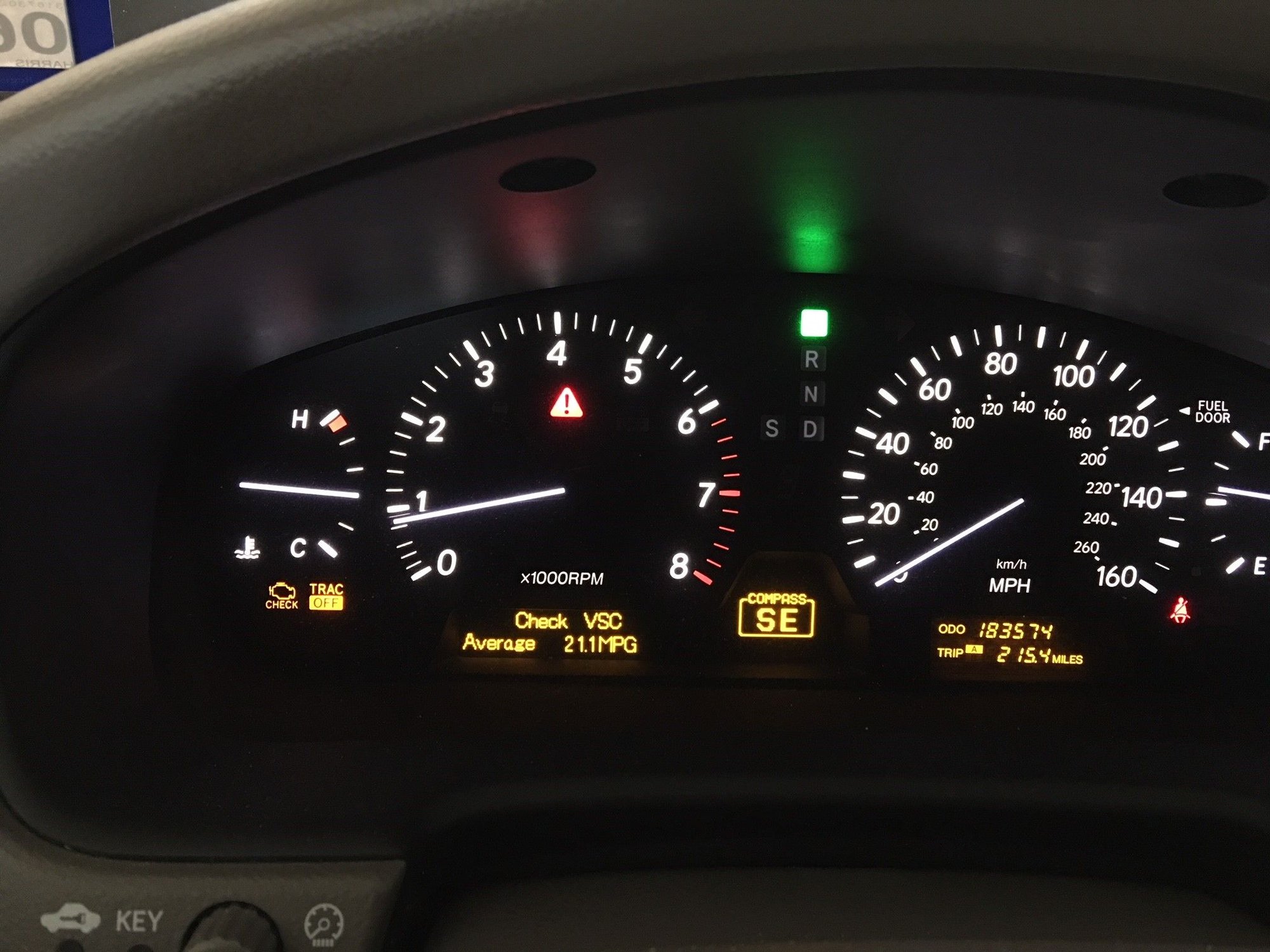

I had a P0420 code show up on my 2006 LS430 less than 2 months ago. Dash had CEL, TRAC OFF, and the Master Warning Light with Check VSC as a message. I found a leak under the clamp in the Y-pipe just past the O2 sensor. Took it to a muffler shop and had them cut out and weld in a new section of pipe on each side of the Y. Cost me $100 and my expectation is I'll never see the problem again. I am happy with the result.
Dash Lights
New Welded Sections
