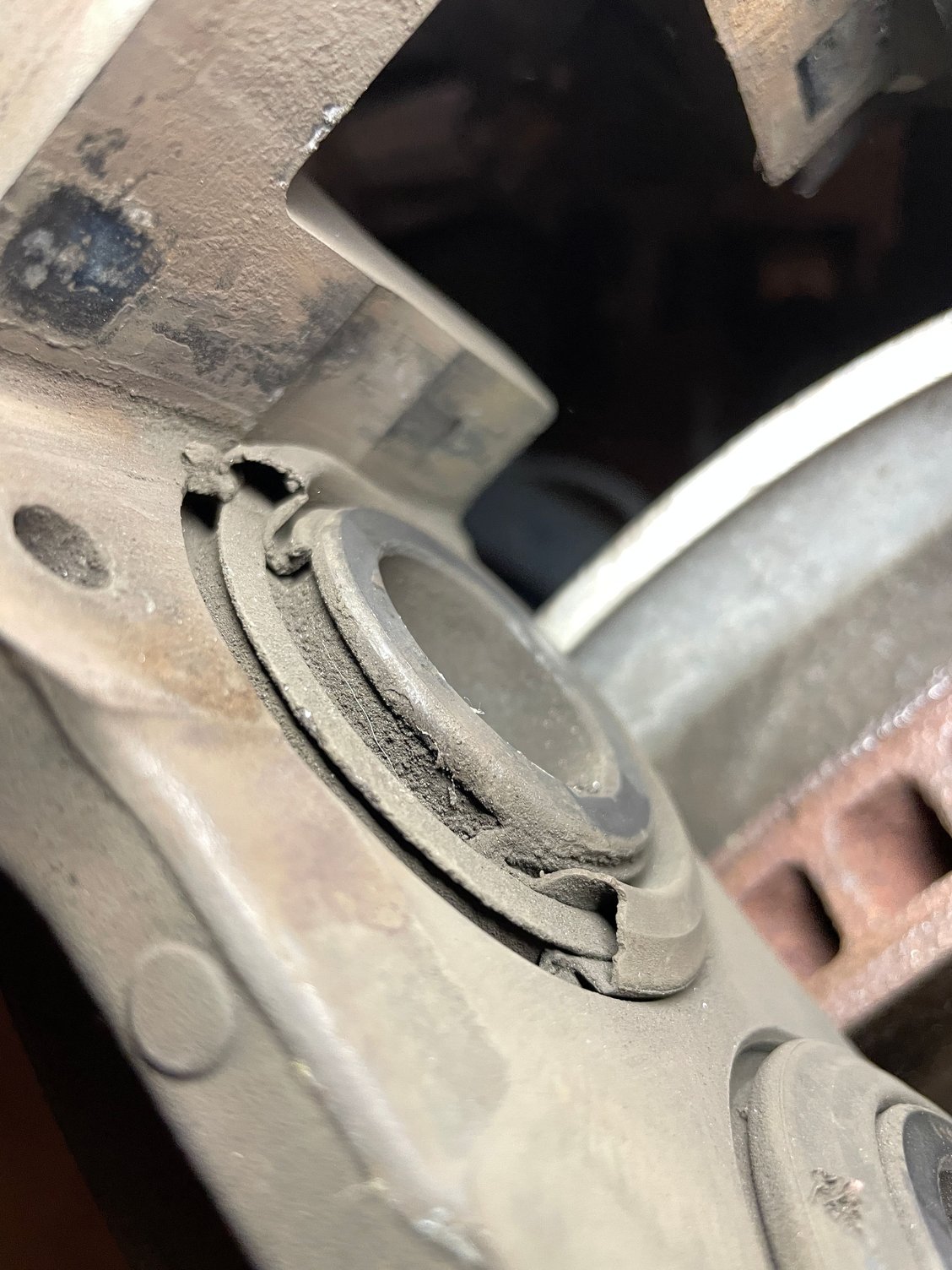

Unfortunately my air compressor is only 6 gal. I will pick up a16 lb sledge. And since I’m replacing the rotors, I will use the old ones for leverage and attach the hub to them. I’m wondering if there’s a possibility of the hub coming off without the bearings. I’d hate to have to deal with that scenario. I also need to rebuild the front left caliper but I don’t have the rebuild kit yet. The dust boot is bad.
How did this happen? It looks chewed up 🤷🏻‍♂️

I had exactly same issue with one of front caliper boots. The piston behind the boot got damaged (rust cavities) too and had to be replaced. I bought an used caliper off Ebay and re-used only one of pistons to replace the damaged one.

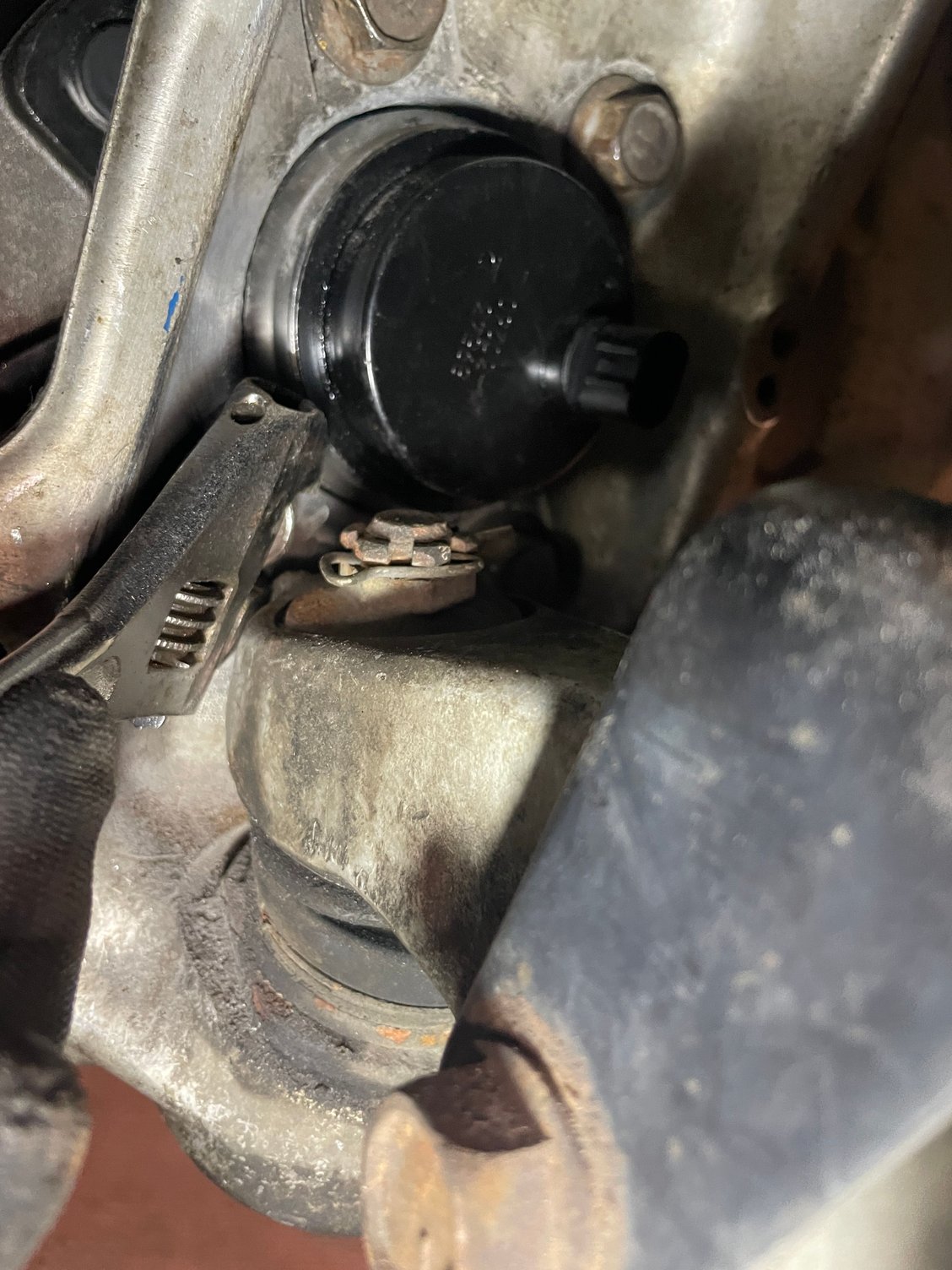

Well, after about 30-50 whacks with a 12 lb sledge, it started to get loose. I continued alternating with 3 different sized cold chisels and kept using the sledge. It came off, finally. I cleaned up the knuckle, put the new one in, and replaced the rotors and pads with OEM parts. Put everything back together and drove for a few blocks. The hub noise is gone, but I have a new, very troubling noise. It happens when I drive over uneven surfaces - potholes, sewers, etc. I will have to figure it out but I suspect that - 1. I didn’t tighten the hub or caliper bolts well enough, or - 2. I cleaned the hub too much with rotary wire brush attached to my Makita drill and the hub/bearing is not sitting in there as it it supposed to. I really hope I didn’t ruin the knuckle. There was a lot of rust and some other substance (white), fused to the knuckle, maybe anti-seize. While reinstalling the hub, I did have a little trouble with the lower bolt that’s next to the castle nut. I coaxed it in using an adjustable wrench until it sat flush with the hub and then used the offset 17mm wrench that I filed down until it eventually fit. I looked for the torque specs for the hub and caliper bolts but couldn’t find it. I remember seeing that info. but couldn’t find it again. If anyone has it, please reply, I will be back at it this afternoon to figure out the new sounds and do the passenger side. And if anyone has any questions, I’ll do my best to answer. Thank you, all who contributed to this thread, there is a lot of helpful information here.
