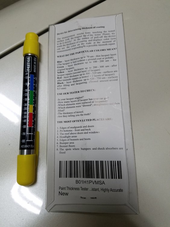

My paint meter also arrived! It was inexpensive at $20 but is a good comparison of paint thickness between our used 2013 LS and 2006 ES 330 that was purchased new, factory paint, and never repainted before...all original scratches too in all its glory. The ES measures consistently in the yellow range, ~225-250 um, across the hood, roof, doors, and trunk. The A-, B-, C- pillars are a little thinner coats and just entering the ~200 um green zone. According to the instructions, green is supposed to indicate original paint and the ES is close to the border of green/yellow.
The LS is consistently ~200 um all around the car before the magnet detaches. So the thinner the paint, the stronger the magnet can bond to the sheetmetal before the pulling force overcomes the magnetic attraction. Nice little device. New formulations and techniques probably allowed Lexus to apply finer, more uniform layers of paint for the LS. However, the consistently thinner paint is also probably why I notice more chips than previous cars that had ordinary, but less delicate paint. Unfortunately, I couldn't get a reading anywhere on the hood...because it is aluminum!
I also wonder if thicker sheetmetal could attract the magnet more and produce a false indication of thinner paint. However, the ES has heavier doors than the LS so I would say the LS has thinner and lighter, but higher-strength steel doors. Here's a video link. I cringed every time that ball-peen magnet hit the paint. I

The reason the paint is more uniformly slightly thinner on the LS is likely because the body is hand sanded, where it isn't on the ES.
That makes sense, Steve.
