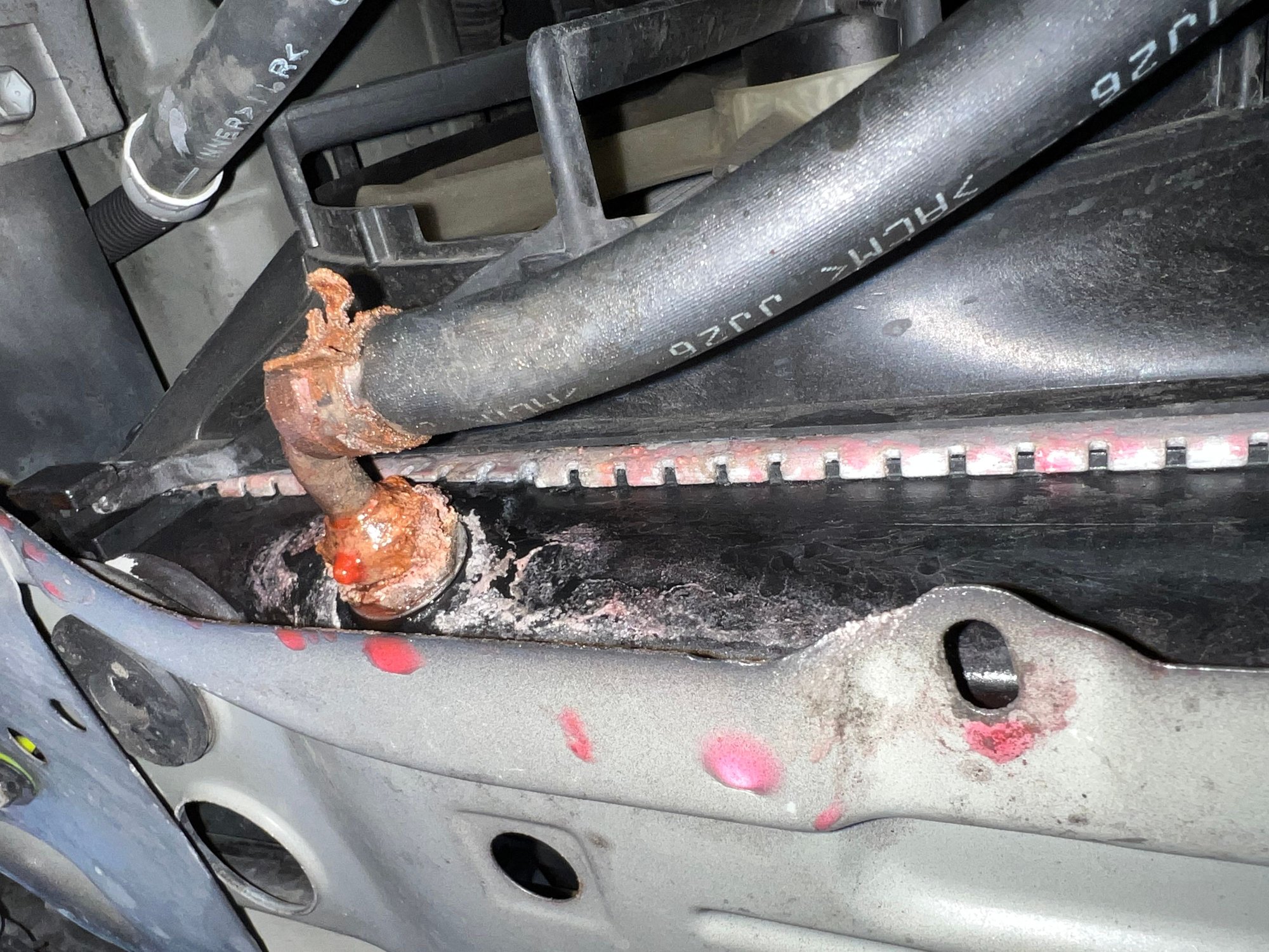

Old Jan 30, 2023 | 04:49 AM
texas008's Avatar
texas008
Joined: Jan 2014
Posts: 778
Likes: 130

Old Feb 27, 2023 | 08:04 AM
texas008's Avatar
texas008
Joined: Jan 2014
Posts: 778
Likes: 130
From: texas
Just replaced the radiator, this time with a Denso radiator from rockauto.
Yes no need to remove front bumper, just need to loosen the grill to have access to bolts at the bottom of the condenser.

Old Mar 24, 2023 | 11:57 AM
texas008's Avatar
texas008
Joined: Jan 2014
Posts: 778
Likes: 130
From: texas
The defective leaking radiator has a lifetime warranty when i bought it from Ebay.
sent message to the seller (Automotive-Cooling) provided all the info and photos required, and then they need a photo of the serial number that's stamped on the radiator. I looked everywhere on the old radiator and could not find a stamped serial number. I even saved the original shipping box with shipping labels on it. anyway, seems extremely difficult to claim the life warranty. just sharing my experience.
