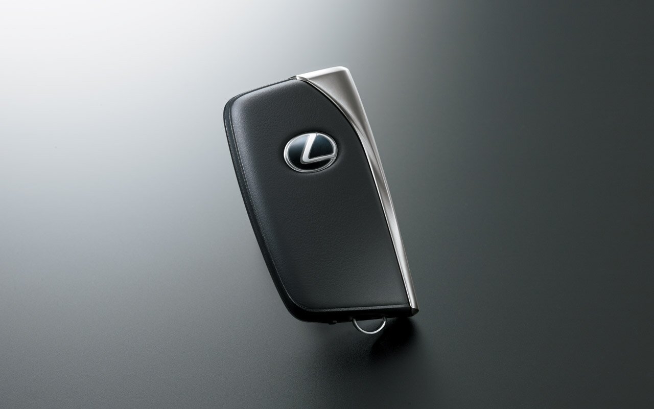

So i did this type of mod with my previous BMW, I'm just wondering how difficult it would be to get the newer styled key fobs on my 2007 ls460L. currently i have one of
http://media.caranddriver.com/images...s-1280x782.jpg
and i wanted to upgrade to the newer one meaning this
http://media.ed.edmunds-media.com/le..._oem_9_600.jpg
it seems like its an easy little mod, and since i had to service my LS recently, they gave me a loaner with the new key fob. it felt more heavy duty compared to the one i currently have and also is there any other types of key fobs our vehicles can have?

That looks like a neat upgrade, I think as long as the key can be "programmed" to your car I don't see why not. From my search a few other folks have mated the 600's card key to the 460.
https://www.clublexus.com/forums/ls4...key-ls460.html
Ask your dealer, although they may give you a BS answer. Hope this helps.

FYI the 13 and up LS uses a new fob that no other model uses as far as I know. The inside chip dimension and buttons are the same as the keys used in the previous LS which means the chip can just be moved over. The other newer models of Lexus keys are that plastic version you showed above which do not share the same button/chip layout in the key. The new key looks like this.
If you have any questions let me know, but I think you would have much better luck and it would be easier to go to the new LS key.
