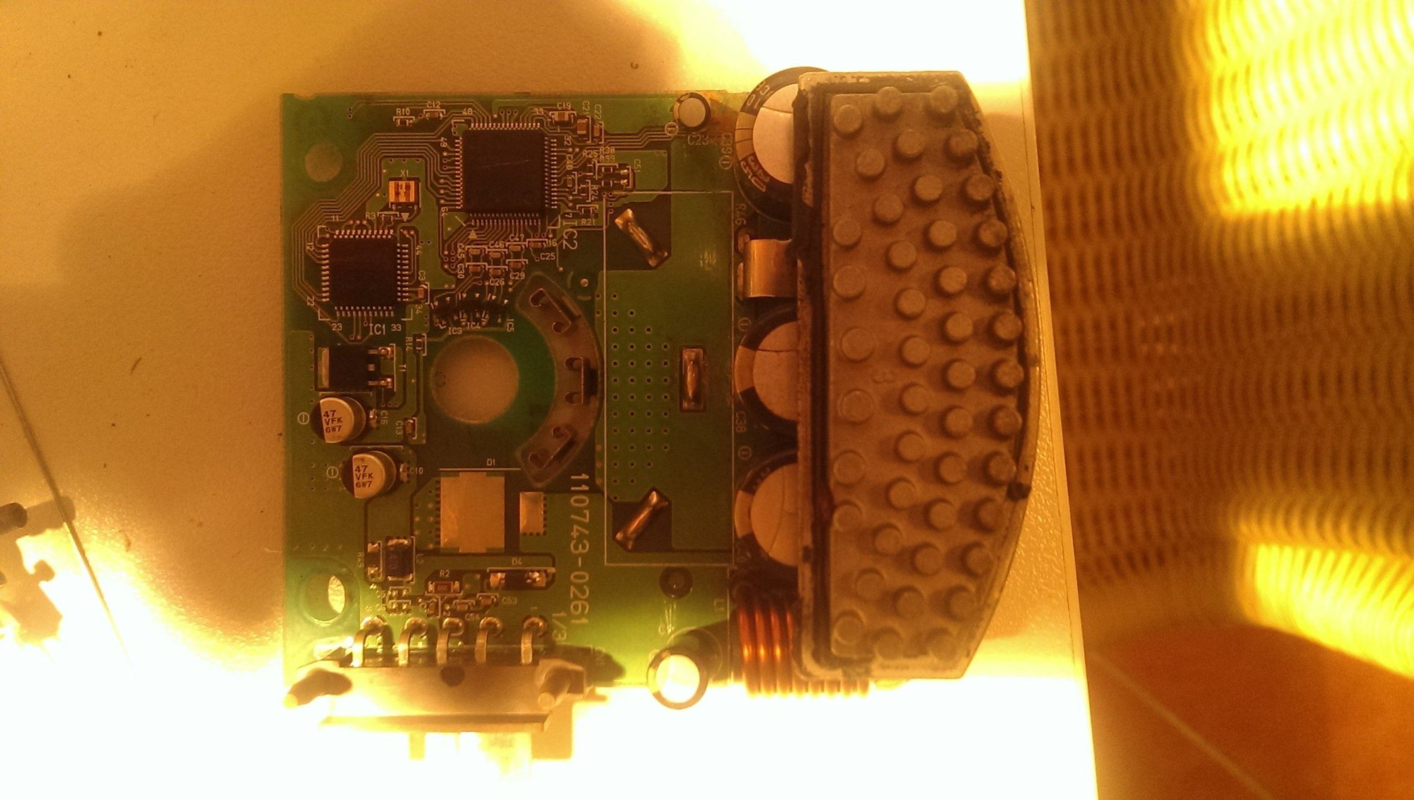

Old Jan 2, 2015 | 09:17 AM
AndreasMUC's Avatar
AndreasMUC
Joined: Dec 2014
Posts: 9
From: Germany
Default controller of blower migth be the problem - Denso 110743-0261
Hallo,
now, I removed the blower unit to identify the real source. The Motor look ok and is a brushless Motor. So this could not be the source.
But before the blower Motor, there is a Controller unit for the brushless device.
The unit is a Denso 110743-0261.
If this circuit is defect - is there a possibility to repair it? Are there known issues to fix after 8 years and 100.000 miles?
The Controller unit has 3 connectors to outside. 2 of them is the Basic voltage and of of them is the steering pin. From the car connector I have measured 12V, but nothing on the steering pin depeding on the blower volume control.
Is there any documentation available where this line is defined?
Thx Andreas
