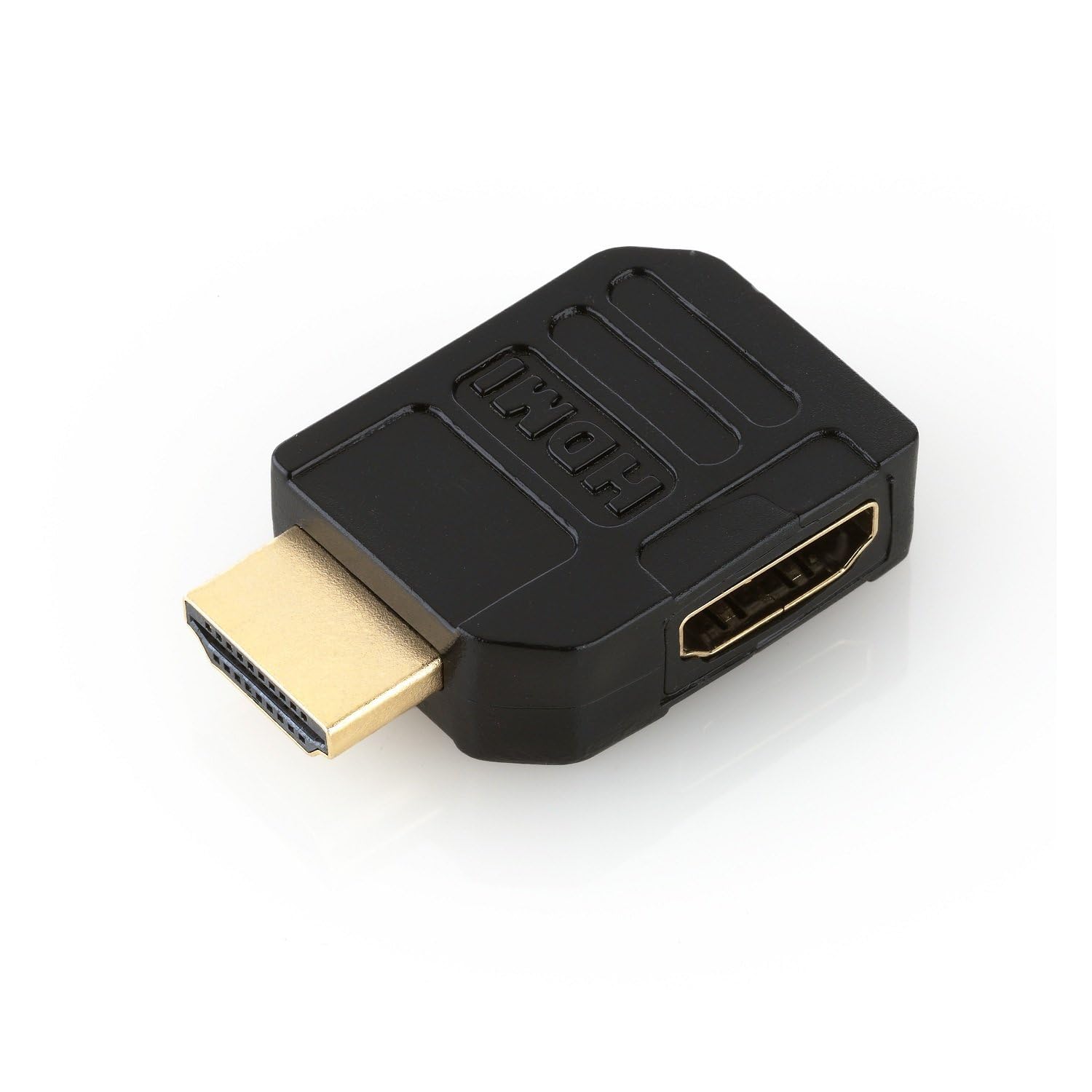

My iVIC is below the armrest in the center console. I bought some parts and modified them, see attachments. Because you cannot bend the cables a 90 degree HDMI adapter is needed. The deleyCON is a perfect choice. My MHL adapter is now build-in in the Galaxy holder. This is a USB power supply (only) usually made for office tables. I exchanged the stock cable by the MHL adapter. A real custom solution but needed as I have the TV tuner in the box as well.
Please note, that iVIC needs cooling. I built an aluminium plate an put it above the iVIC. The remaining box is large enough. And the good news: I added two USB connectors, one for audio from iVIC USB and one for the TV tuner to play videos from USB. Great stuff! A real name: in Vehicle Infotainment Center (iVIC)!
