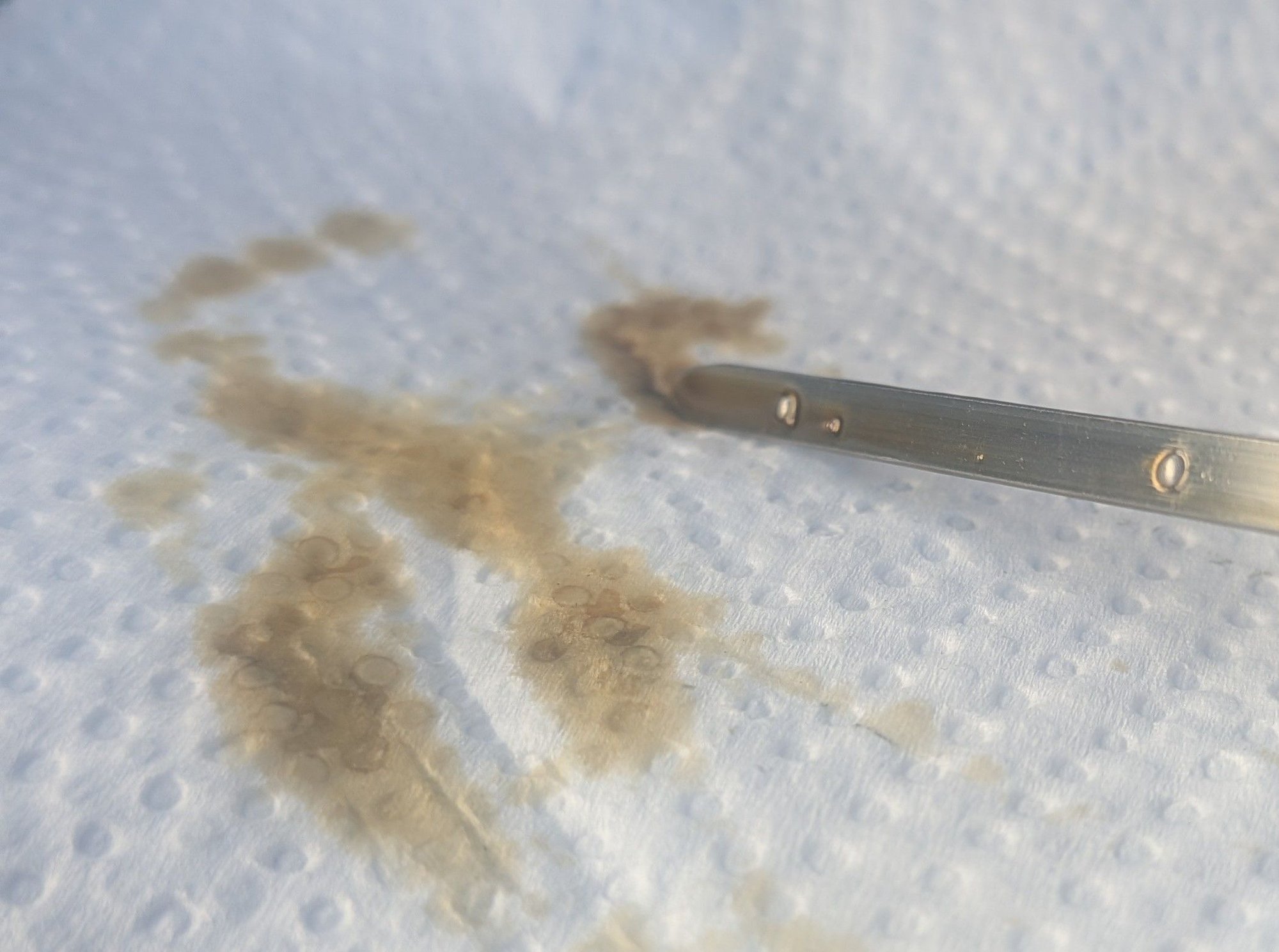

Fuel trims are a new one for me, this is what shows after warmed up. Will check out while driving. Also pic of oil after about 7,500 miles (due for change), about 3/4 up the dipstick so prob down about a pint. Not bad for 300k miles!
