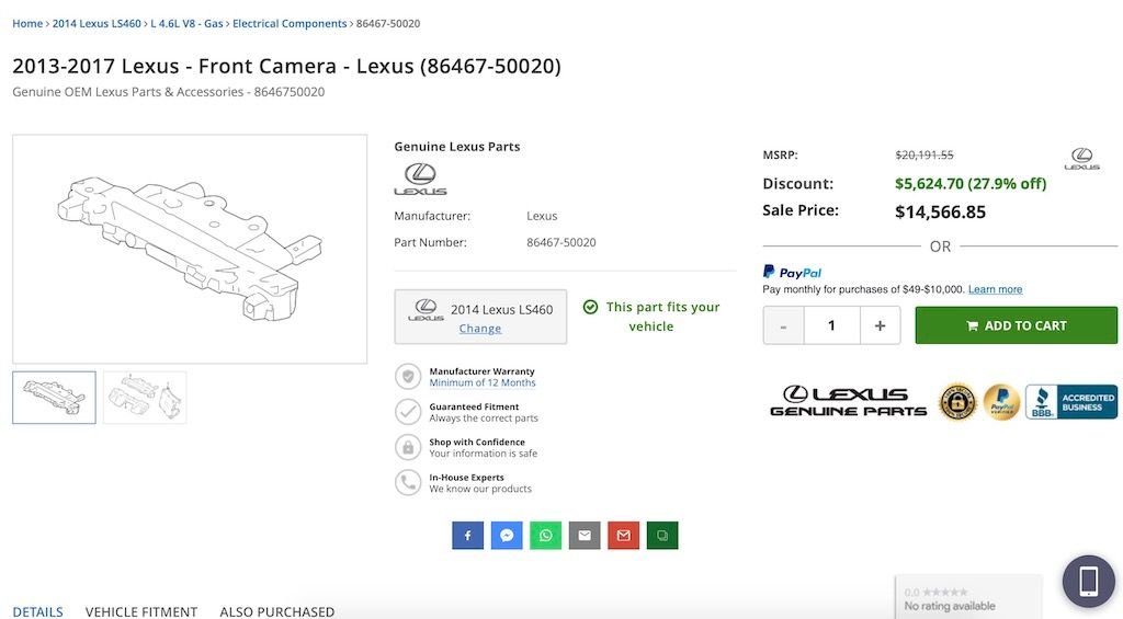

You had better hope the issue isn't the front camera...I doubt that it is though.
