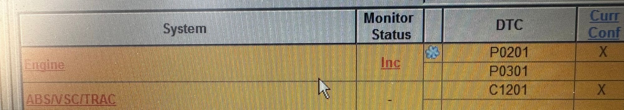

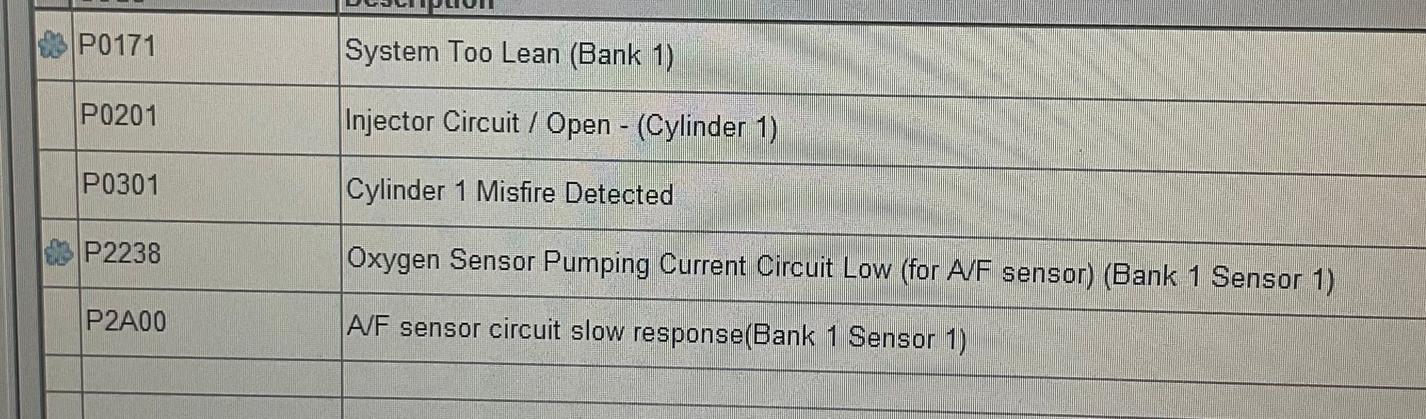

Hey guys i have 2007 Lexus ls460 140k miles which has a flashing yellow engine light. After attaching a scanner it gave us P0171 P0201 P0301 P2238 P2A00 C1201 these codes.
Upon inspection we did find few drops of oil in cylinder 1 spark plug so we changed the valve cover gasket, Spark plugs, & Ignition coils. It stopped the vibration and drives smooth.
but these codes still persist P0201 P0301 C120.
We have checked all the connections and they seem fine
anyone else faced the same problem before?
I need help and suggestions. thank you in advance

It tells you that there is an issue with one of injectors on cylinder 1. There are 2 in total.

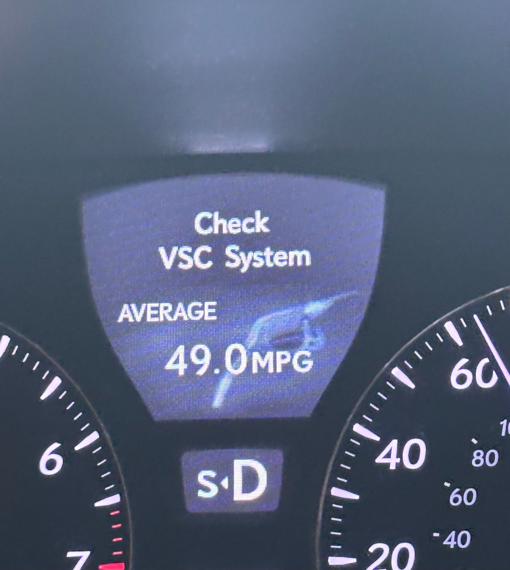

could it be an electric issue.?? I had a VSC code pop up every now and than but goes out in couple of days. Could it be the electric junction box on the pax side which is notorious for failing on this model. Now issue seems to be electric as its not getting enough electrical power. I’m exploring all options before going for injectors as they are extremely expensive. Thank you for ur time.

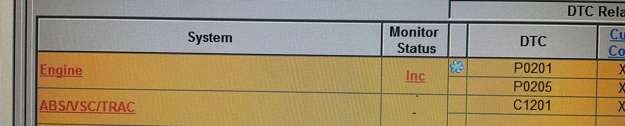

alright I’m done with the swap and here are the new codes. From P0201 &P0301 it went to P0201 & P0205. Any insight?
Old Apr 27, 2025 | 07:12 AM
Anfanger's Avatar
Anfanger
Joined: Aug 2020
Posts: 2,852
Likes: 1,001
From: NH
Make sure you connected everything properly. If it is the case, it seems that one of the injector drivers is bad.
On other hand, P0201 remained. I would do compression test and visual inspection of the first cylinder. If that checks out, I think, port injectors are used during start up. It might indicate an issue with the first cylinder port injector.
