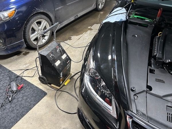

Short question - does a battery maintainer charge the battery as good as the car's alternator?
Long story:
I have a 2007 LS460 L (RWD) with about 120k mileage. I don't drive it a lot and it stays in the garage for most of the time. When the battery drains, I start getting the famous "3 warnings" - VSC, ABS and Brake Systems. After driving the car for a few days, those warnings go way. Google search indicates those warnings will show when the battery is low, when the computer cannot read the sensors. Makes sense.
To prevent the battery from draining, I connect the battery to a maintainer (trickle charger) when I parked in the garage. I disconnect the maintainer before I drive the car. The car starts every time. The battery is 100% healthy according to battery testers. However, the famous "3 warnings" always show up every time. And they won't go away unless I drive the car continuously for a few days. If I drive the car everyday and don't use the battery maintainer, the warnings will never show up.
I am trying to understand the logic here. If the maintainer charges the battery as good as the alternator, why would those warnings show up? Is it possible that the warnings are not related to the battery at all? If that's the case, what they are related to? I know for sure those are not permanent warnings as they always go away after I drive the car for a few days. Thank you!

Not necessary battery related issue. I see on the photo you have your parking brake is set. Are you leaving your car on the parking brake for a long time? If yes, try to park your car without engaging your parking brake when you put it away for the extended period next time. You might have sticky parking brake actuator or something else of that nature that prevents normal brake release when you take it out of storage. Maybe your brake system just needs some good servicing.
