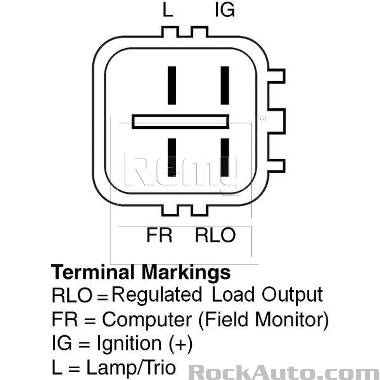

If I'm not mistaken this LS is a "half way" setup going by the following pin-outs either way I haven't heard of the 460 having charging issues except when the alternator is on the way out.
Interesting, so not a fully active one but still a feedback controlled system. Huh, I've never had to look into it since none of mine have had issues nor have I had to really deal with too many customer cars with UR alternator issues.

What does “half way” set up mean in regards to the alternator?
Not a fully active charge controller system, nothing to worry about we were just talking about system strategy
