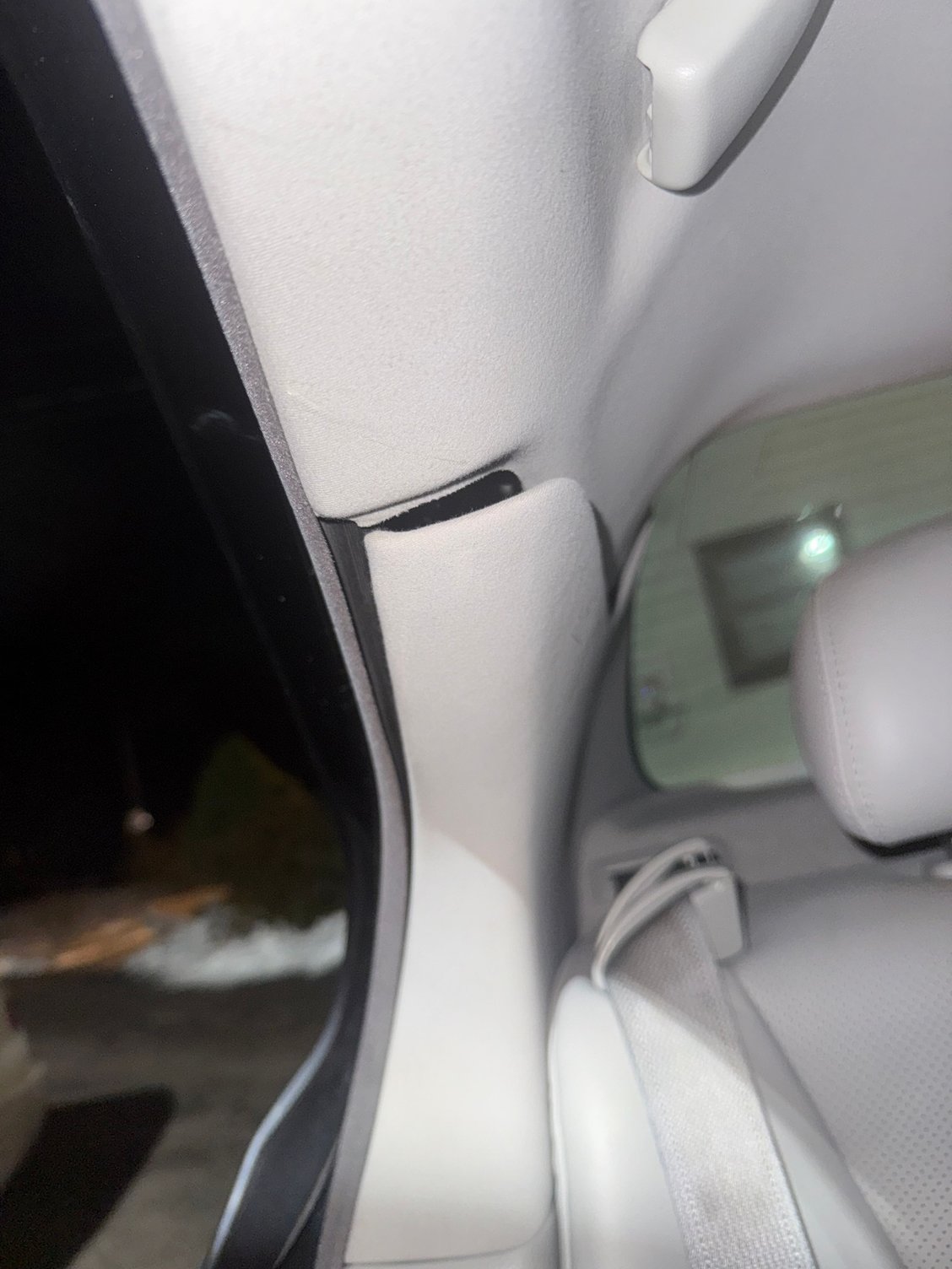

After car was towed to me when I purchased it I noticed the back curtain passenger airbag cover popped out on one side. I saw where I can push it back in but I’m being a nervous Nelly. By me pushing it back hard will that cause it to go off? Excuse my terminology if I’m saying things wrong. Thanks in advance. You all are amazing help with my new car

Why did the cover pop off? Is there structural damage? Need more info.

Car is fine. I think it bounced around but he was definitely a reckless driver because as he was back in and off the gooseneck trailer, he ripped the bottom plastic engine splash guard off no big deal. I’m fixing that.
Here are the pictures of what I’m talking about.

The airbag isn't attached to that cover its bolted onto the body behind it. You have a better chance of it never going off than it activating by accident. You should check with a flashlight to make sure it's still in there.

lol oh wow ok. Tomorrow in the daylight I will try to push it back in but I will take a look. What am I looking for? A white bag?

It's been a few yrs since I did the speaker upgrade on my car, the bag itself might be in the panel above the one that's loose. I think it's in a blue or white bag...just shine a light in there you'll see it.

My airbag is def in there.
Does anybody know where I find these blue pushpins? I can’t find a part number and or what they’re called but my two are broken and that’s why the piece keeps falling down.

Kinstecks 25PCS Trim Door Panel Clips Trim Panel Retainer for Toyota Tacoma Tundra Camry Corolla Avalon Sienna Highlander Land Cruiser RAV4 Lexus 90467-10188

damn your good. Thank you. Just ordered
