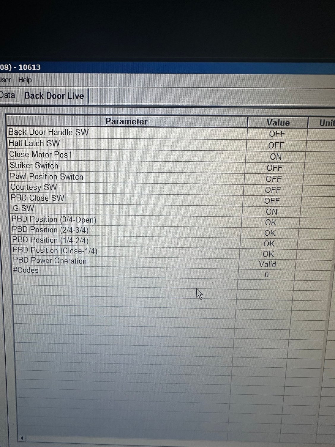

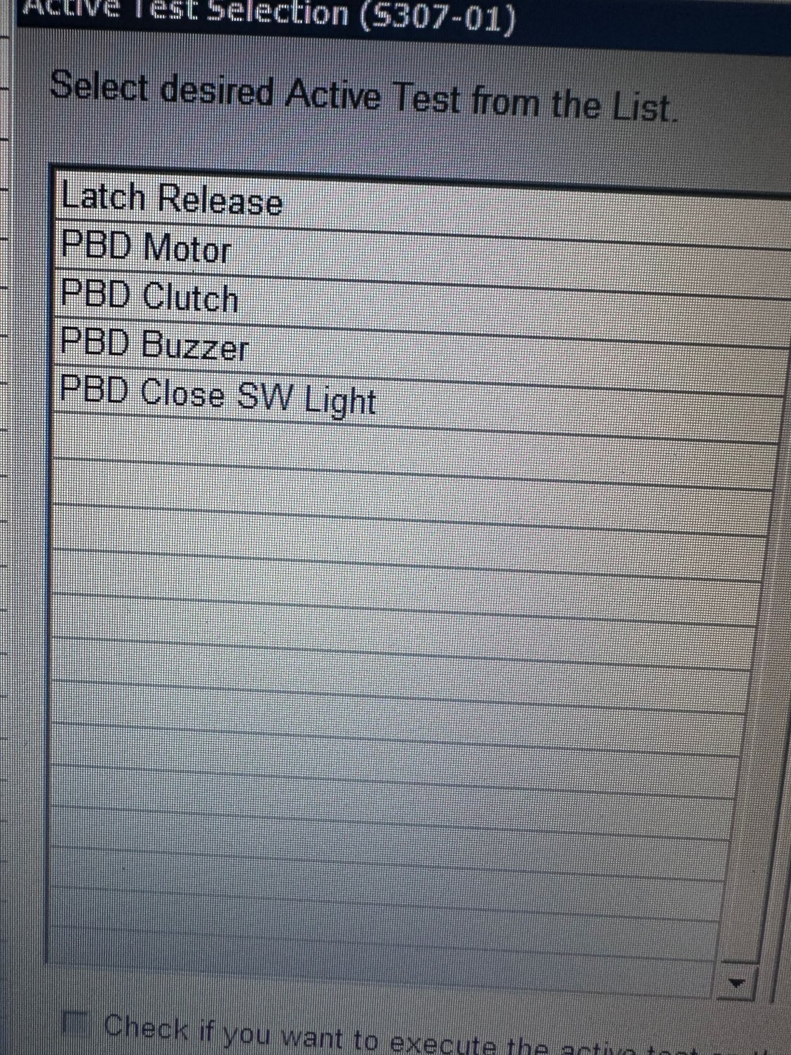

Old Feb 1, 2025 | 09:08 PM
Jose2007's Avatar
Jose2007
Joined: Nov 2023
Posts: 51
these are the options I’m getting in tech stream. I tried the latch release option but it actually locks it all the way when I keep it open slightly from manual key. Doesn’t open it for some reason. All other functions work fine. Please advise if anyone has faced the same problem. Thank you in advance.
