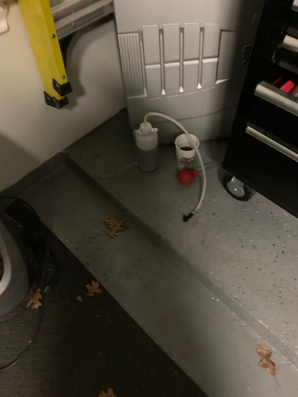

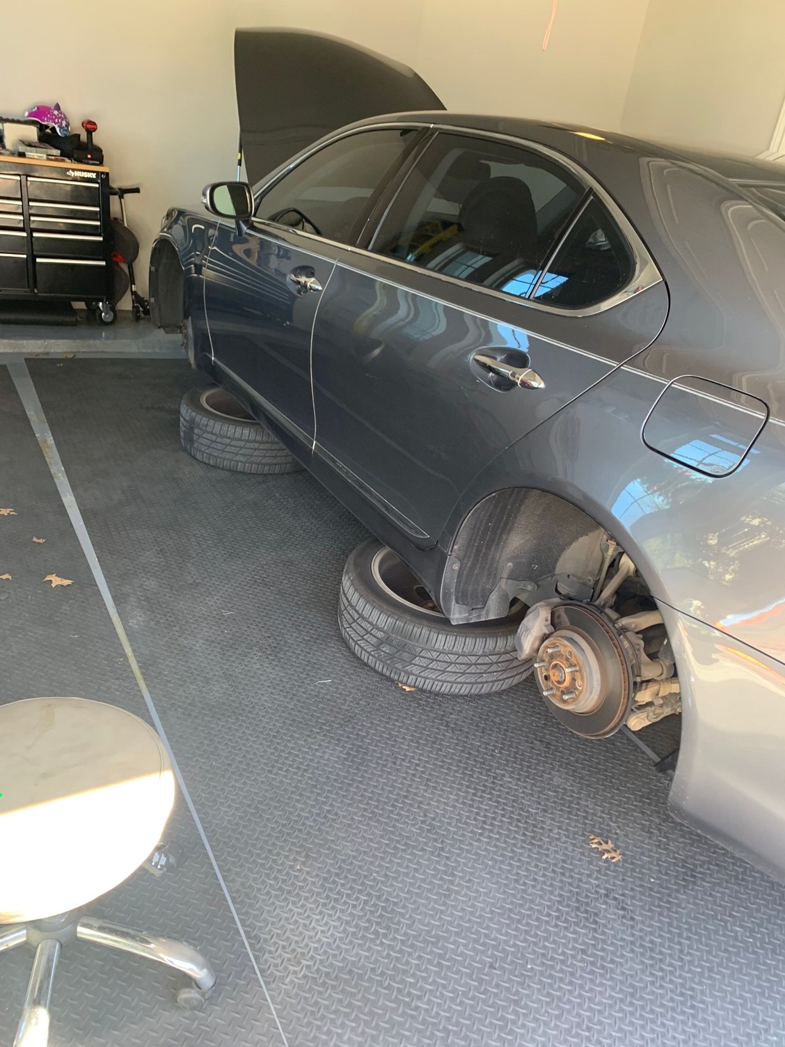

Hello All - Again thank you to everyone for the feedback and help! My brake parts came in today and I spent the better part of the day replacing the pads and rotors on all 4 corners. When done I started the process to flush the old brake fluid. I will have an update here shortly.

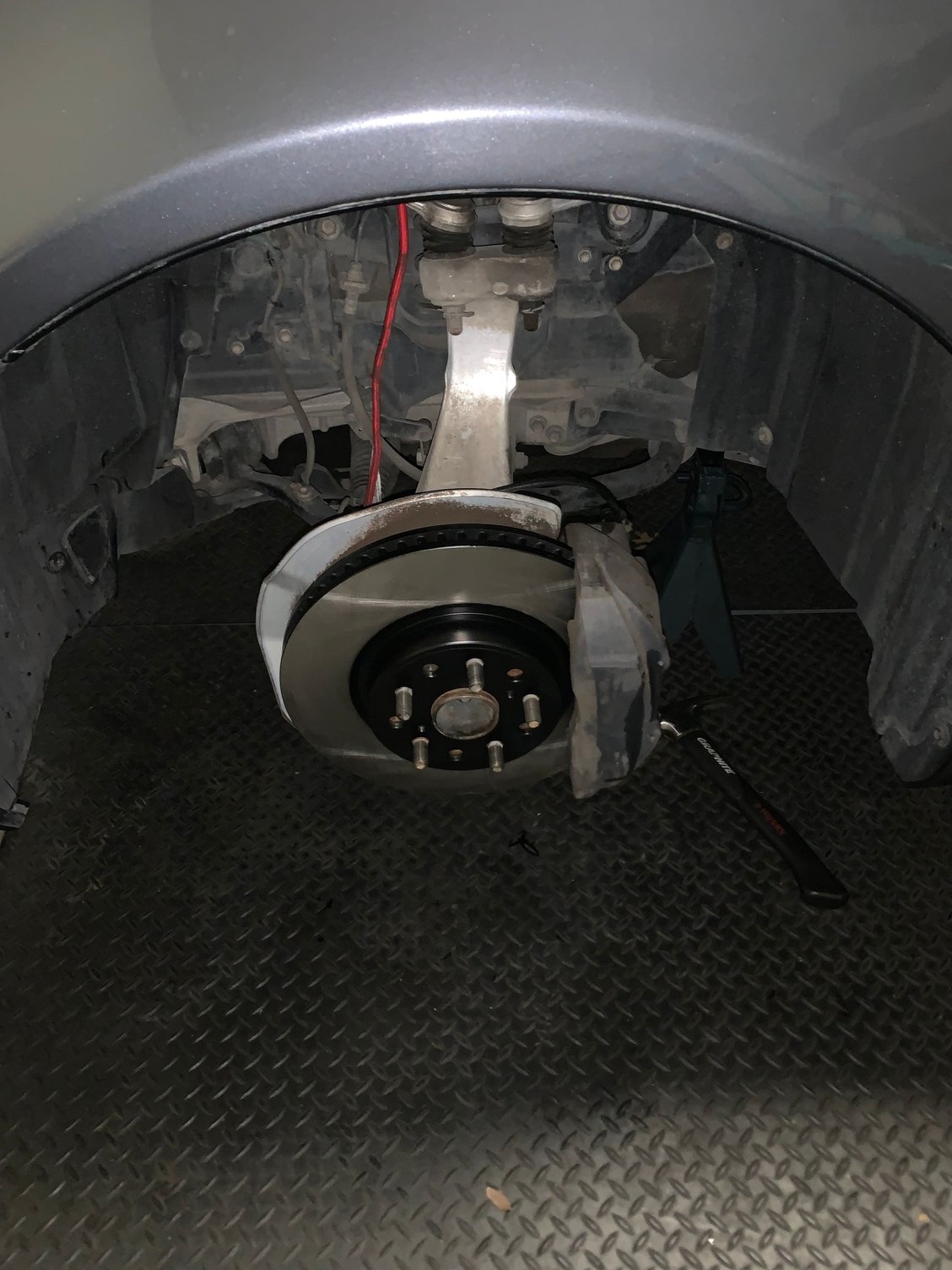

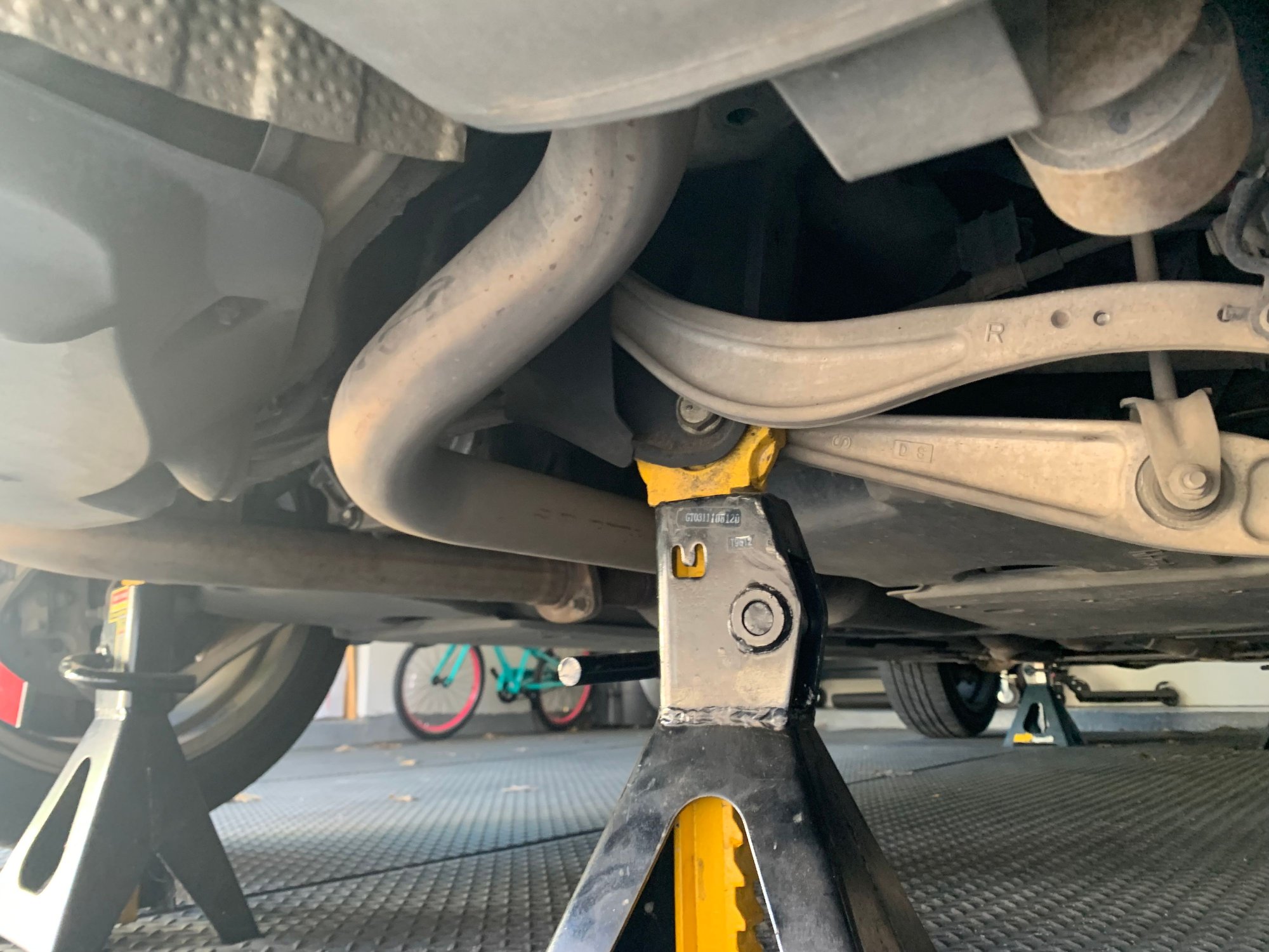

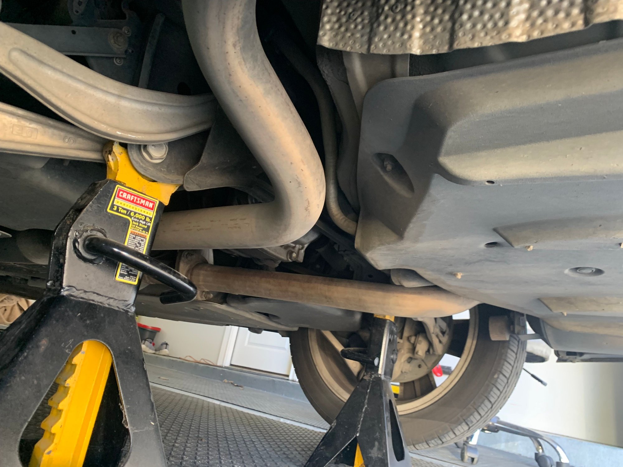

Old Jan 18, 2025 | 09:33 PM
jefthim's Avatar
jefthim
Joined: Feb 2006
Posts: 361
Likes: 71
Originally Posted by Marc780
Awesome, Jefthim can you post the images from the brake job yet?
It was my first time to have the car up in the air so I took quite a few for me to review and examine, but it looks incredibly clean for a car with 158,000 miles. I'm happy to say the the brakes are done and the flush is complete with no DTCs in the ECU. The fluid was very very dirty.
