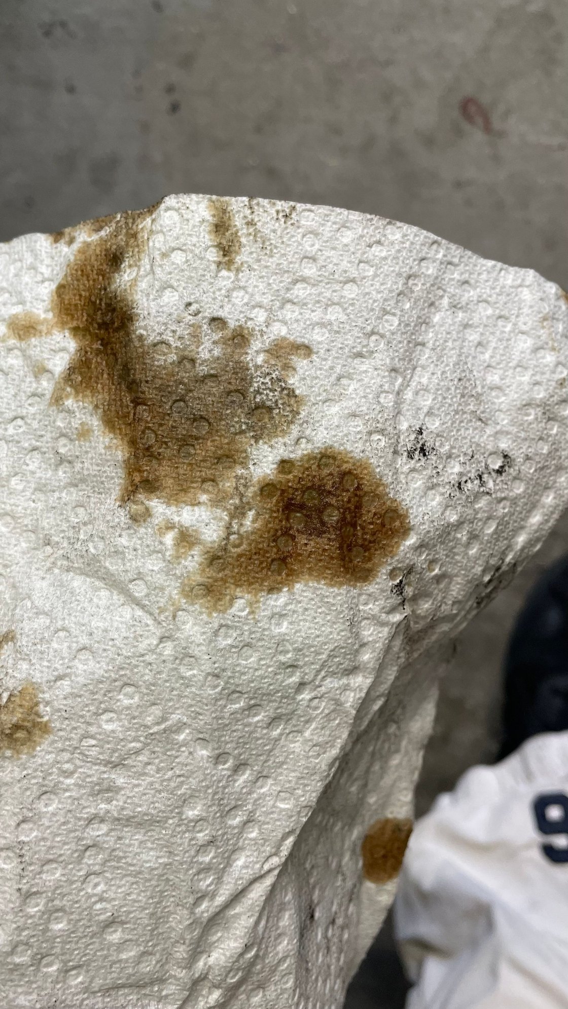

I can proudly report that I flushed out 14 quarts with toyota ws atf following one of my previous posts on my old LS430
https://www.clublexus.com/forums/ls-...e-at-home.html
I stopped at 14 quarts because the fluid started coming out "mostly" red.
This car w/ 209,000 miles shifts soooo much better now. I'm not going to go as far as to say it drives as if it were brand new but heck... pretty much..
I didn't follow any relearn procedure.. perhaps I can bust out the tech stream but I'm not sure it's necessary. Car is shifting like a dream... if the car will figure it out on it's own.. all the better.
