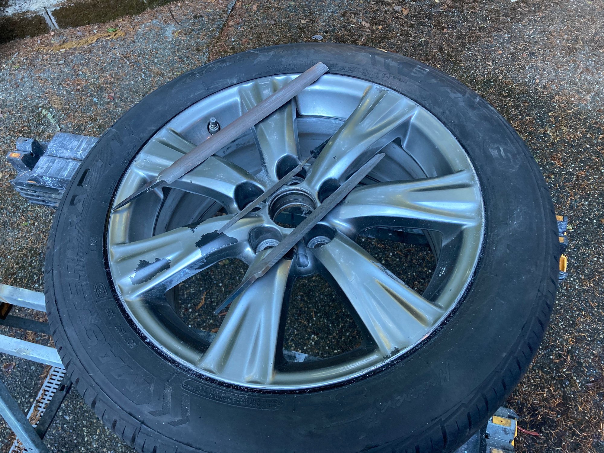

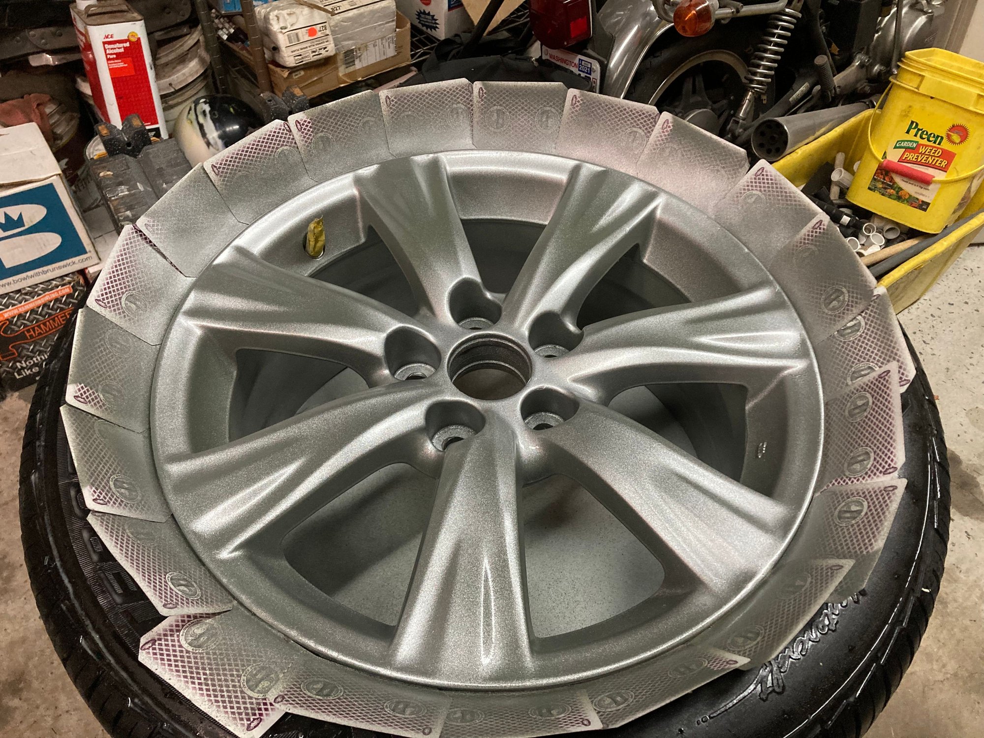

I agree with this. The wheels on the 02 es bubbled in a lot of spots for no reason. The Hyper Silver on the 09 GS was worse, and peeling in places for absolutely no reason.
I just refinished the GS wheels myself because I couldn’t take it any more. I had to file out not only curb rash, but bubble spots down to metal to then build/sand/etc. it back up before painting.

Originally Posted by Gerf
I like that card trick.
It really works well, and you can do a decent job on the edge filing/filling/sanding even w/the tires on. I’m doing a Volvo set right now wheels off. Easier, but don’t let wheels-on deter anyone. I can’t recall where I saw that trick, but I did not invent it.
