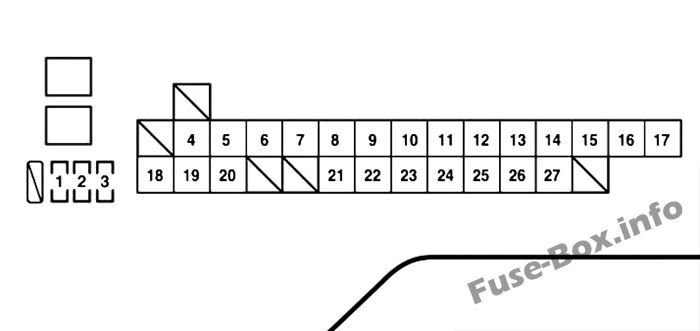

Try these.EPS fuse (80A) in Engine Room J/B No.1
E/G RM-IG1-1 fuse (10A) in Engine Room J/B No. 2
EPS ECU fuse (10A) in Engine Room J/B No. 2

where is the first one located? I pulled the fuse cover but I don’t see most of the fuses?

Try google to locate fuse boxes by model year.

Assignment of the fuses in the Engine Compartment Fuse Box №1 (2009) № Name Ampere Circuit
P-J/B 20 EPS 80 A DC-DC converter
