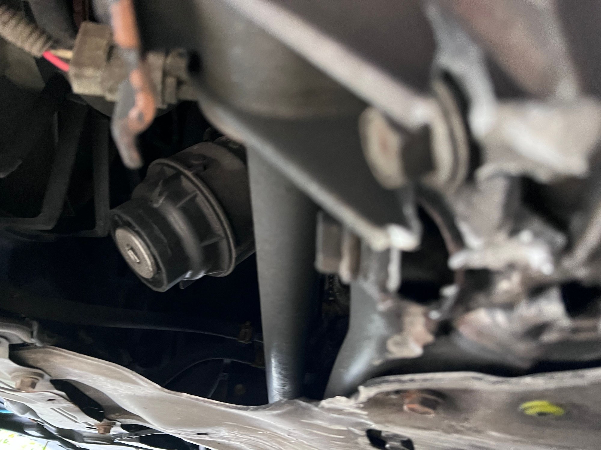

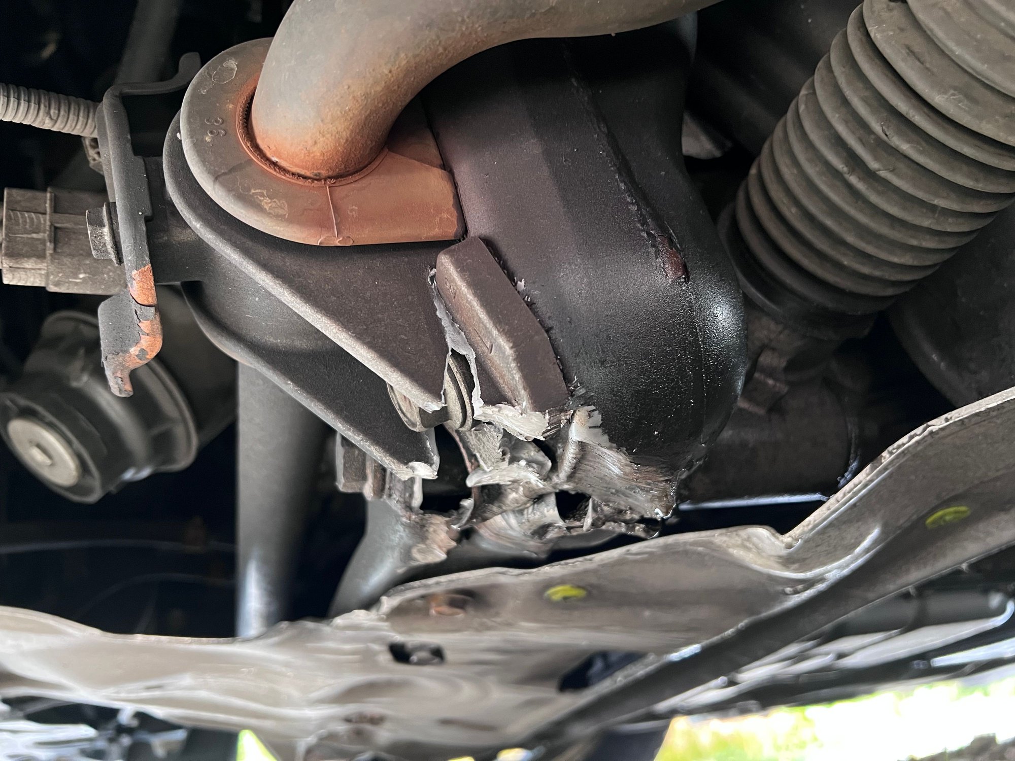

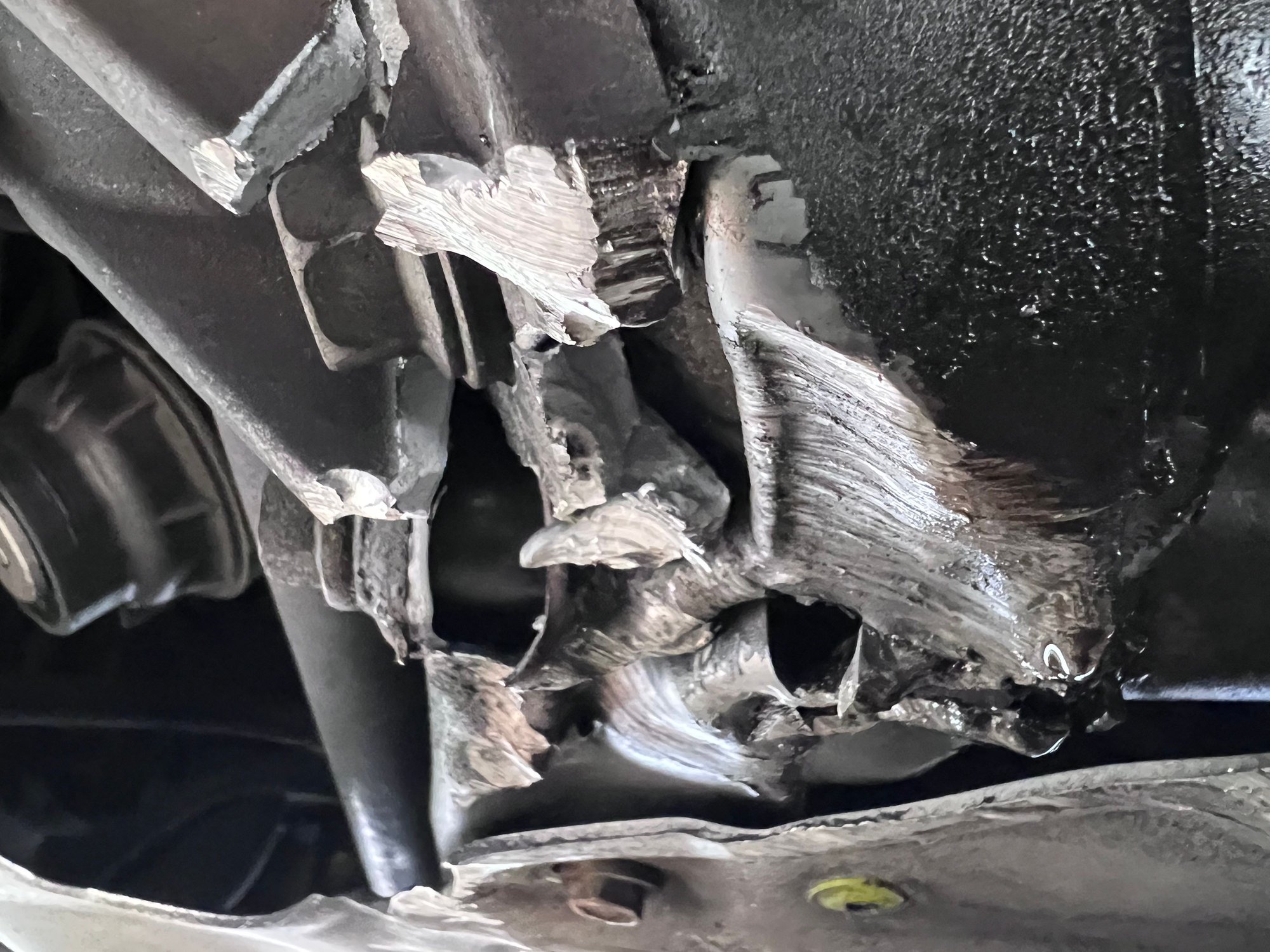

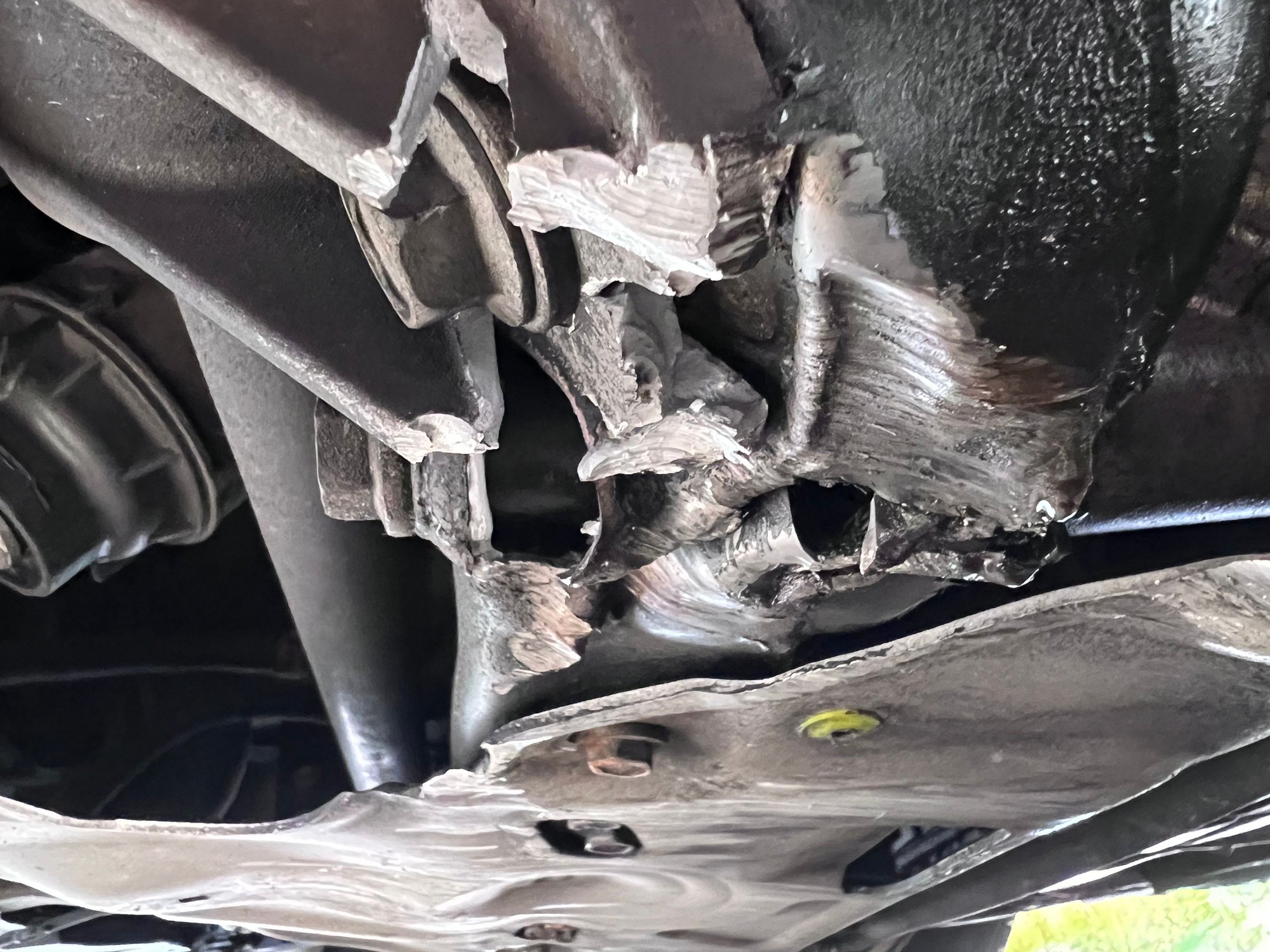

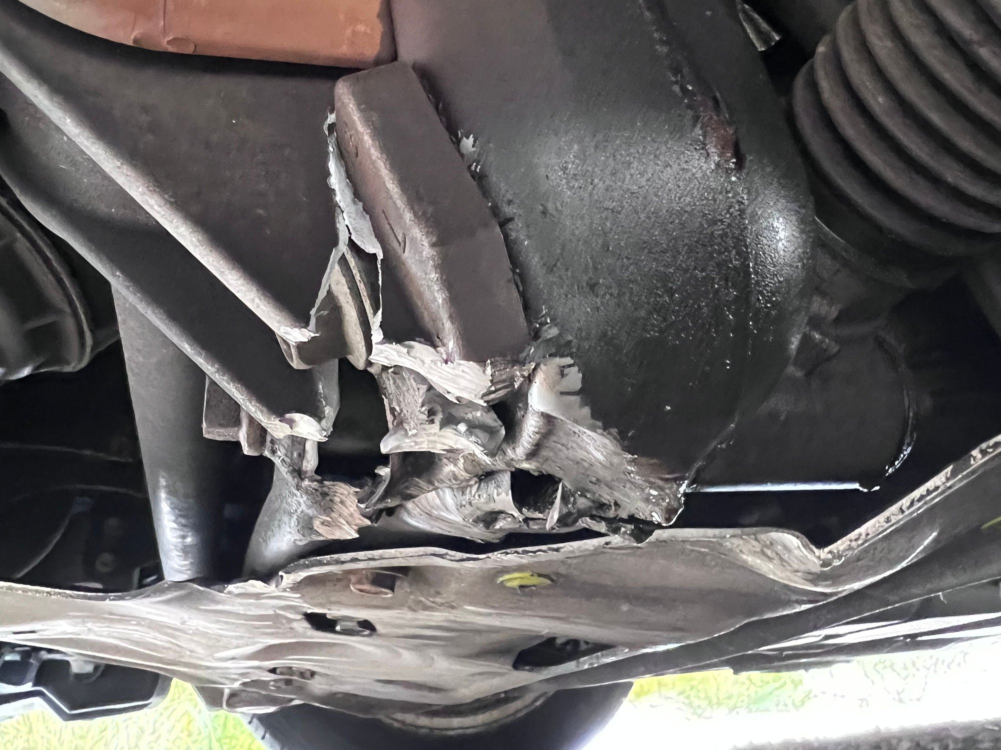

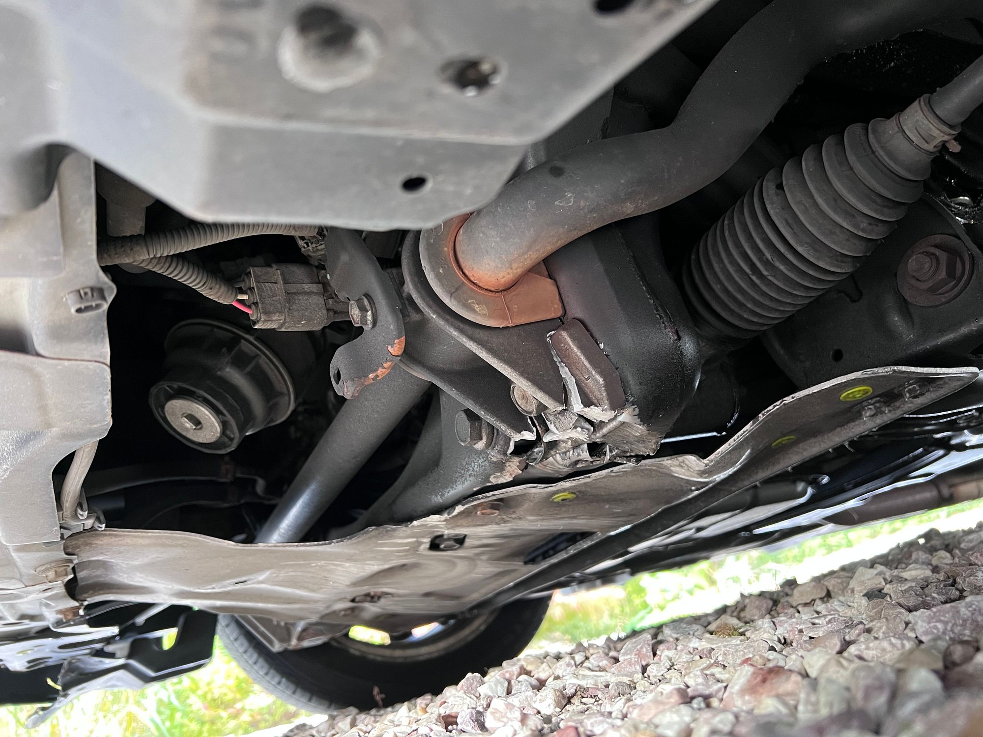

During a stormy night on a dark street I hit a huge pothole at around 40mph. The whole front end of the car bottomed out in a pretty big impact that took me by surprise with the impact.
Fast forward to the morning I noticed some significant damage. Besides front bumper requiring some bodywork, I'd like to get help identifying the damage I saw to the driver side. I took a look at the lexus parts site and couldn't see anything that matches up. Maybe the "engine cradle"?
Here are pics I took. First couple:, the DS damaged side chunk taken out from the impact.

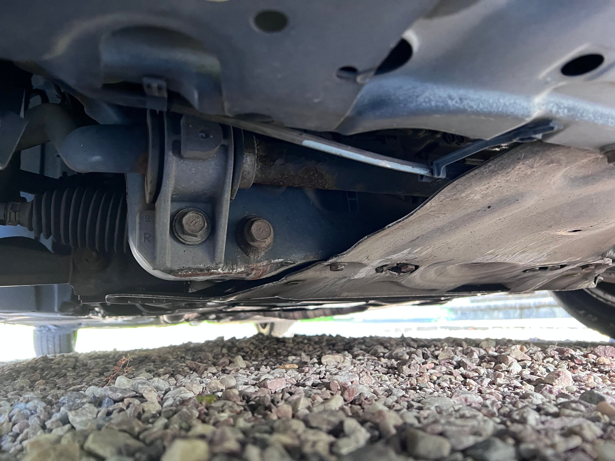

Last two pics—I include the passenger "good" side for comparison.
So the looks of it, the sheared off corner houses the sway bar and could wear away over time —certainly vulnerable to the next impact.
Can anyone tell/direct me to identify the part name or part number? I want to file a claim against the city get it into an estimate. I tried taking it to a auto body place but they were talking lots of smack that I wanted to stay clear of.

Looks like it's subframe. Heck knows if damage went further...
What year and body type?

https://www.lexuspartsnow.com/oem-le...ss_member.html
That's an extensive repair many hours labour.

51100-50030
But frame geometry needs to be verified.
