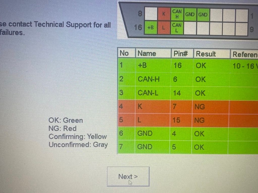

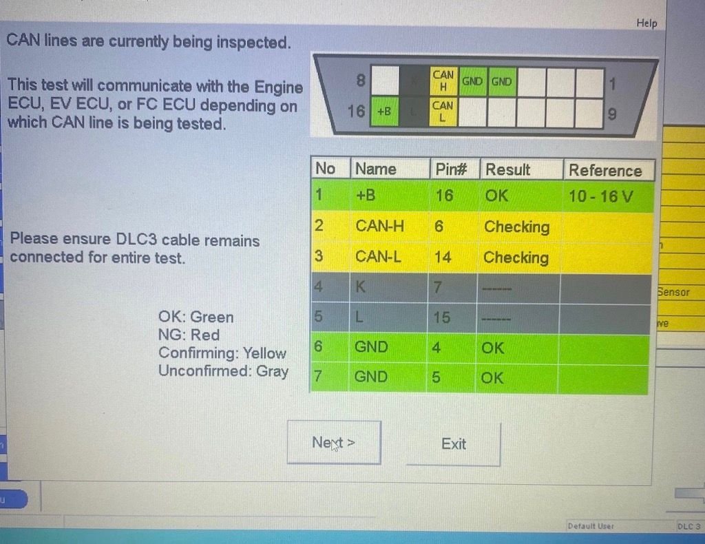

If you're ever wondering why your knock off techstream isn't working properly a cable test on your J2534 vci will tell you, at your own risk of course.
I will share this info that I got from a friend to save you the trouble.
PS....Looks like the search for a good fake cable has been a long one.
